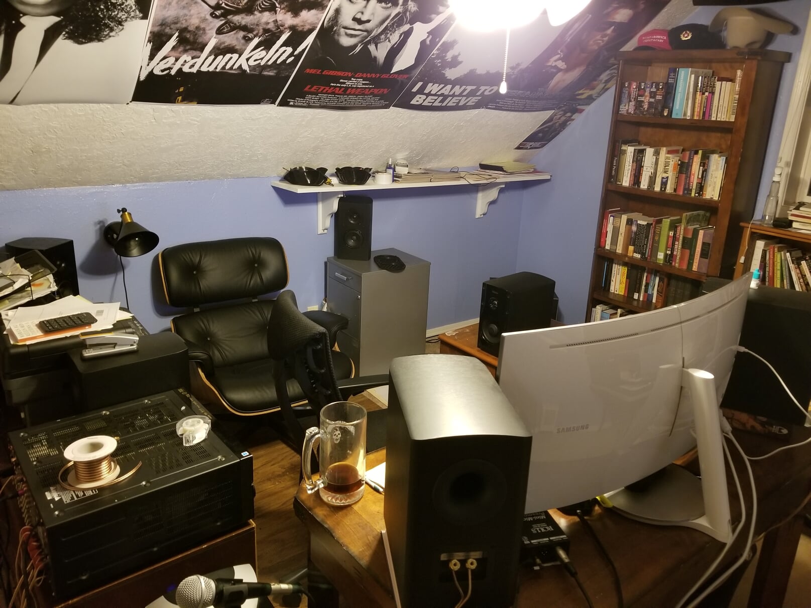

I'm pretty frustrated right now. I bought a 94txh on craigslist and a Jamo 5.1 for 150 bucks. A good deal. I'm gonna sell the Jamo speakers. Don't have a use for them.
The receiver was made in Nov 2007. 140 watts. MCACC. 7.1 etc. etc. Listed weight is 41 pounds, actual weight is 37. The first rat to be smelled.
I've got six speakers(4 SM45, 2 BS22). No center channel. Dual sub. This is a computer set up. The room is approx 15x12 and because of the low and angular ceilings is only 1200 cubic feet.
So I get it all set up. Add some speakers. Move some stuff around. Tweak some settings. I look through my games. I look through my movies. There is hardly any material that is 7.1. I know that people complained about the dearth of 7.1 stuff out there, but I always thought they were exaggerating.
And so I thought to myself. I'll play Skyrim. The 94txh will upmix the 5.1 to 7.1 and it will be more immersive. But THE UPMIXING COULD NOT BE MORE STUPID. It just sends 99 percent of the sound to the rears and calls it a day. What a bunch bullshit.
I am pissed. Royally pissed. I have had my eye on this receiver for months. I thought that it would solve my problems, but at this point I am really considering going back to a 4.2 sound card/phono/Sony DA2 set up I had before. And hell, I liked the sound of that set up more anyway. The treble is too hot on the 94txh and it won't play as loud at the da2.
I ran the DA2 at a 109 DB and it wasn't a problem. I hadn't even reached max volume. The 94txh won't touch 109db. And here I thought that going from the 100 watts of the DA2 to 140 watts of the 94txh would yield more DB at the very least.
My entry level Pioneer atmos receiver upmixes well. It's got like 80 watts and 7.2 channels. I'm running it in 5.2.2. The front height speakers are located above the TV, at a 45 degree angle, near the ceiling. And when upmixing DTS 5.1 or Dolby 5.1, the sound stage is raised. It works. And for old stuff like Miami Vice BR, I upmix the stereo to extended stereo, very cool. I'm very happy with that receiver. Hell, I should probably experiment. Bring it up to my office and see what it can do.
I expected the 94txh to work on a similar level. For it to make my gaming more immersive. And it didn't. Did I make it mistake? Or is this the way it is?

Ok. I figured it out. I set the playback in windows for 7.1, and I thought that Windows would send a 5.1 or 7.1 signal depending on the source. It doesn't. If I configure Windows to 7.1, it finds the rear speakers and sends the 5.1 mix there (Windows 7). And PLIIx won't kick in because the receiver thinks it's receiving a true 7.1 signal. However, once I set windows to 5.1, PLIIx kicks in and 94txh upmixes.
I got Doom (2016) to work in 7.1 today. I'm not sure why it didn't work yesterday.
I haven't fiddled with the volume settings or reset the receiver.
As far as weight goes, I'm just reading the stats off crutchfield and pioneer.com and the scale in my bathroom.
Tomorrow, I'm going to see if I can cure the treble by using my sound card to connect to the phono inputs on the 94.
