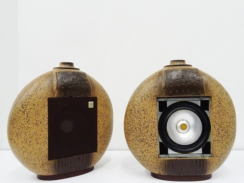

Unfortunately Ted was not a detail man as far as build details, as my father and I found out fast. The drivers Ted produced under his brand were the most frail of the lot.
We actually got the JW driver very reliable, but back then it was all tubes, mainly 10 to 15 watt per channel. It became a different story when amps like the DCA 300 A appeared and even the Quad 405. Then those drivers got turned into cocked hats at regular intervals.
I still have quite a few JW modules, and used four originally as my Atmos speakers. However they started to fail. So then I bought four Mark Audio CHN 110s. They have held up well in this application, with zero issues. They are driven by Quad 405-2 amps. I do drive the system at concert levels. The JW modules and the CHN-110 model very well in TLs by the way. During my med school years I used a pair of JW modules in TLs, topped out with the STC (later Coles) tweeter, driven from my home built Mullard 10-10 tube amp, driven from a Quad 22 preamp, which I am still using on my Decca/Garrard turntable.
You can see that that CHN-110 which is basically the latest iteration of the JW module, is an excellent driver. You can see that it does have excellent dispersion, and it has a good FR right out to the listening position. My strong hunch is that is in fact a better approach than those exorbitantly expensive Perlisten units. So, I am going to stick to my view that, that driver is most likely the optimum choice for the Atmos ceiling application.
In summary, it is a fact that the only FR drivers that are of any practical use are ones designed and built to Ted Jordan's principles and patents. He got it right, and this should never be denied.
