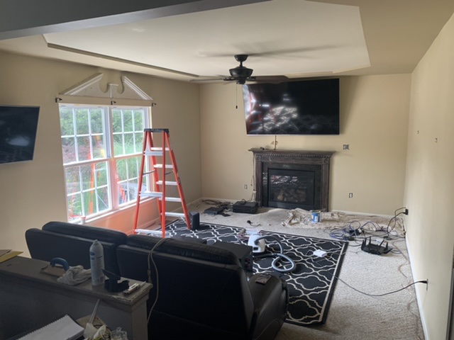

For the room, it’s clusterF right now. I’m undecided how I want my furniture, I do have the surrounds and rear surrounds where I want them, but that’s it. I have a modem/router/Hue light system on the right side of the tv (that’s where I have coaxial). On the left side on that old trunk, I have PS4 Pro, and 2 Yamaha receivers. One runs 5 speakers outside and the other runs my 7 channel in the living room.
Room is 18x24 with the partial wall leading to the kitchen.
Im pretty sure I am doing a built in on the right side. That’s the wall to the garage and I can put all the receivers, PS4, modem/router etc.I’m there and have room to do the wiring from the garage. That will leave my entire front space open. That will give me room to move the Cantons wider and better place the subs. Im probably going to take the purple couch away. Here are some pics I took before the Cantons came in and we were patching some holes and painting.

Before I did anything tho, I moved stuff around while doing sweeps with no correction and no filtering (pure direct) to find the best spot possible for my subs and speakers before applying anything. The closer you can get it with a little positional eq the better, easier and less invasive the adjustments and corrections are.
That’s what I’m going to do first, until the DSP comes in. Do you think it’s good to do this with the full speakers as well, or just use positioning and listening to get those the best?

Oh! Oops, lol. Well... when it comes to your towers I think distance and proper toe in are more the focus. Not too close to any walls, as close to an equilateral triangle as you can get. Your room won't have as much an impact on fr with the higher frequencies.
I will say the images of your smaller speakers right up against the fireplace is making my ocd flare up, lol. I'm not a big fan of the one image where your tv is close to the kitchen and kinda high up on the wall either.
Yeah, I’m new to all of this stuff, so when I first put those bookshelf’s up, it was a disaster. I have 3 kids, all gamers, so I threw up a second tv in the living room, so they weren’t always in their rooms playing. Have another PS4 Pro back there, so as it is ghetto looking, I care more about convenience and ease of use then overall aesthetics. My WAF is not an issue, so I could do whatever I want with no concerns there. I’d rather have the best gaming, HT Experience, music, instead of worrying what some others might think that come over and visit.
