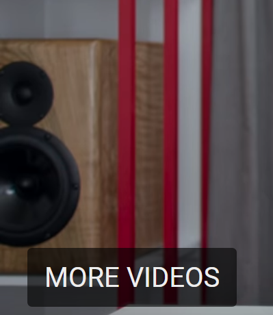

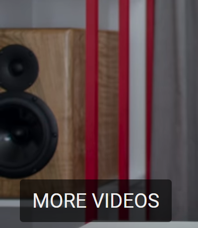

… However, the dude must be a genius, because his own monitors in the background sure look like my MB0w1's in Salk cabinets. I don't know what else they would be.
Those monitors on the shelves on either side of the dude, look to me like they have ~1" dome tweeters, not the ¾" tweeters of the MBOW1. If so, could they be the A/V-1 sold by GR Research sells, or something similar with a nicely finished cabinet? It uses the same woofer as in your MBOW1 and MB27 designs, with a different tweeter. That tweeter mounting plate looks like it's slightly dished in or recessed, as if it's a controlled dispersion type design.
Here is one of those speakers enlarged from a screen shot of the video.
Swerd
Swerd
While I'm looking at screen shots, here is an enlargement of the frequency response.
That loss of response is hardly a polite "dip", its a chasm. It begins at 2 kHz and continues to above 8 kHz. It bottoms out between 3-6 kHz, but the response begins to drop gradually between 1-2 kHz, and drops more noticeably between 2-3 kHz.
On the treble side of that broad chasm, the response returns to ~87-88 dB between roughly 6-8.5 kHz. And it gradually gets to 90 dB somewhere between 10 and 20 kHz.
To my eye this looks like the Grand Canyon of BBC Dips. All this makes me wonder what the unfiltered frequency response of the woofer looks like.

You may be right. The key would be the number of screw holes--the 0W1's only have 3, and Danny's tweet has 6, at least in the latest model (the T3), But my aging eyes can't make out the screw holes.
I enlarged a small section of a screen shot from the video. It's too pixelated or out of focus. I can't make that out those screw holes with my surgically enhanced bionic eyes.
I looked at the video again, full screen. At 1 minute, look at the monitor on the left side of the screen. I think I see 4 screw heads on the tweeter.
Swerd
Swerd
Here's a Salk version of the MBOW-1. The 3 screws on the tweeter mounting plate are clearly visible. Also, note the relatively small size of the ¾" dome compared to the larger looking tweeter dome in the video.

OK... Took one for the team. In the following JBL 530 video, clip beginning at 21:41, he identifies them as X-LS Encores (from GR). He also mentions a GR Research Studio Monitor at about 20:50.
I think this might be the monitor they are talking about at the earlier timestamp:
Thanks for the detective work. I was thrown off both my the cabinet and the tweeter, which isn't the same one Danny has been using in his budget line. I'm kind of surprised he published the horizontal off-axis plots. Even I would worry about the peak on the 40 degree measurement.
