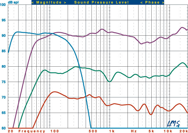

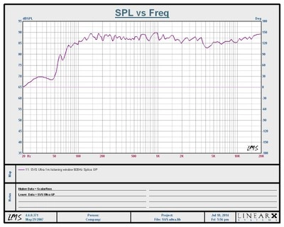

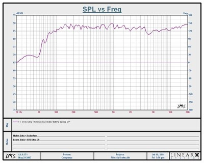

It doesn't seem their measurements squared with the ones Gene posted previously:

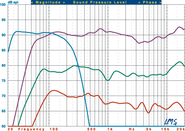

Or this from Sound & Vision (Purple trace):
Looking at these graphs, the Ultra looks like a much better speaker. ;) Even though I wouldn't choose that dip around 4K, I wouldn't condemn it! :p ...Or think it needs a fix! (I'm very glad that they didn't go there... I don't know if I could stand another 20 minutes of prattling about how it could be "better.")
From an educational standpoint, It would have been cool to see the individual measurments for Woofer and Tweeter.
The measurements from New Record Day do actually follow the other graphs if you look at the scales. Gene's graph has an awful lot of reflections in the measurement, but if you squint, you do see the same overall trend. The speaker was deliberately voiced to be on the mellow side.

Am I seeing more detail in the NRD chart? I see what looks like a drop across the spectrum from ~300-4K, with the exception of that bump around 400. (going by memory, pls forgive). I don't feel like that trend is even apparent in these two other graphs.
Pogre
Pogre
It doesn't look as exaggerated but I do see the trend.
