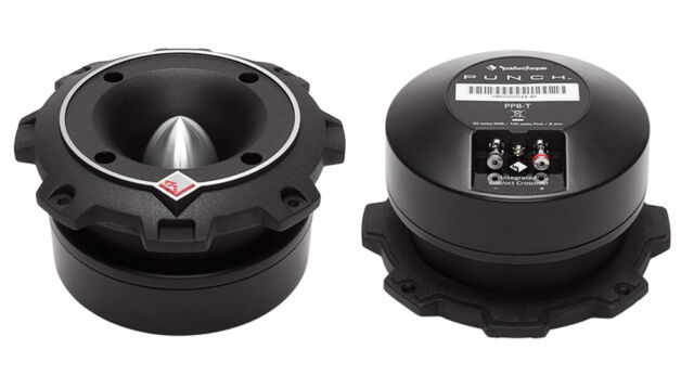

Some tweeters are hard to take for long periods- it may be an inherent flaw, might be bad crossover design, etc. When JBL came out with their Titanium domes in the late-'80s, I couldn't take it. A few years later, I heard the MB Quart titanium tweeters for car stereo and I liked those but when I would hear JBL Ti tweeters, I still didn't like them, so it's not as simple as saying that my hearing changed. I like textile domes and some ribbons, although I admit that I haven't listened to many different speakers lately.
I need to admit that my deleted comment about compression tweeters was based on this type-
I went to a car audio shop yesterday and saw one of these in the display case and I can't imagine being in a car with them.
This type of compression tweeter strongly resembles the first one, the 075 that JBL built and that was used in the SR8 Olympus enclosure, and which by the way was most likely JBL's best enclosure ever built. That tweeter used aluminum at the time, I guess:

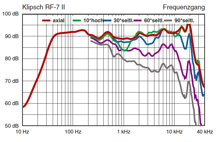

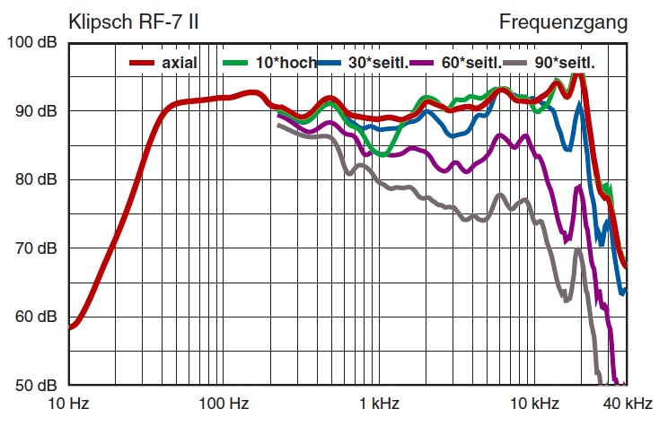

The RF7 III may be too new to have any measurements published, but if it is anything like the RF7 II, then you could right, for those sensitive to the 12 to 18 kHz range, those speakers need to be listened to off axis a little.
Klipsch RF7 II Measurements | AVS Forum
My big question is, are the RF7 III better, or worse?
So the usual listening window from 200Hz-10kHz is about -1dB to +3dB, or +/-2dB average, which is pretty good. Most people above 50YR probably can’t hear beyond 15kHz, but even at 15kHz, it’s -1dB to +4dB, or average of +/-2.5dB or no more than +/-3dB, which is still good.
Only reason I brought this up was because I thought the listening window was like +/-6dB or some crazy stuff :eek: , not +/-2dB for listening window on the Klipsch.

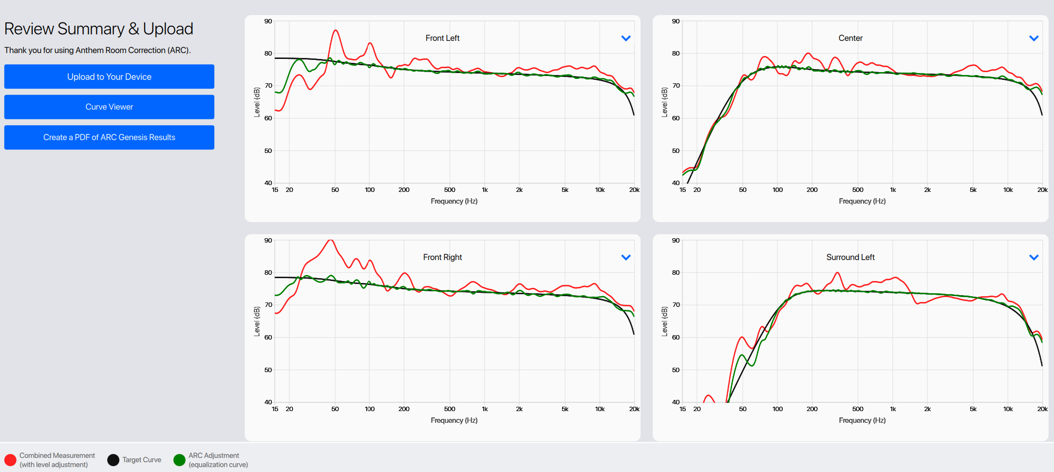

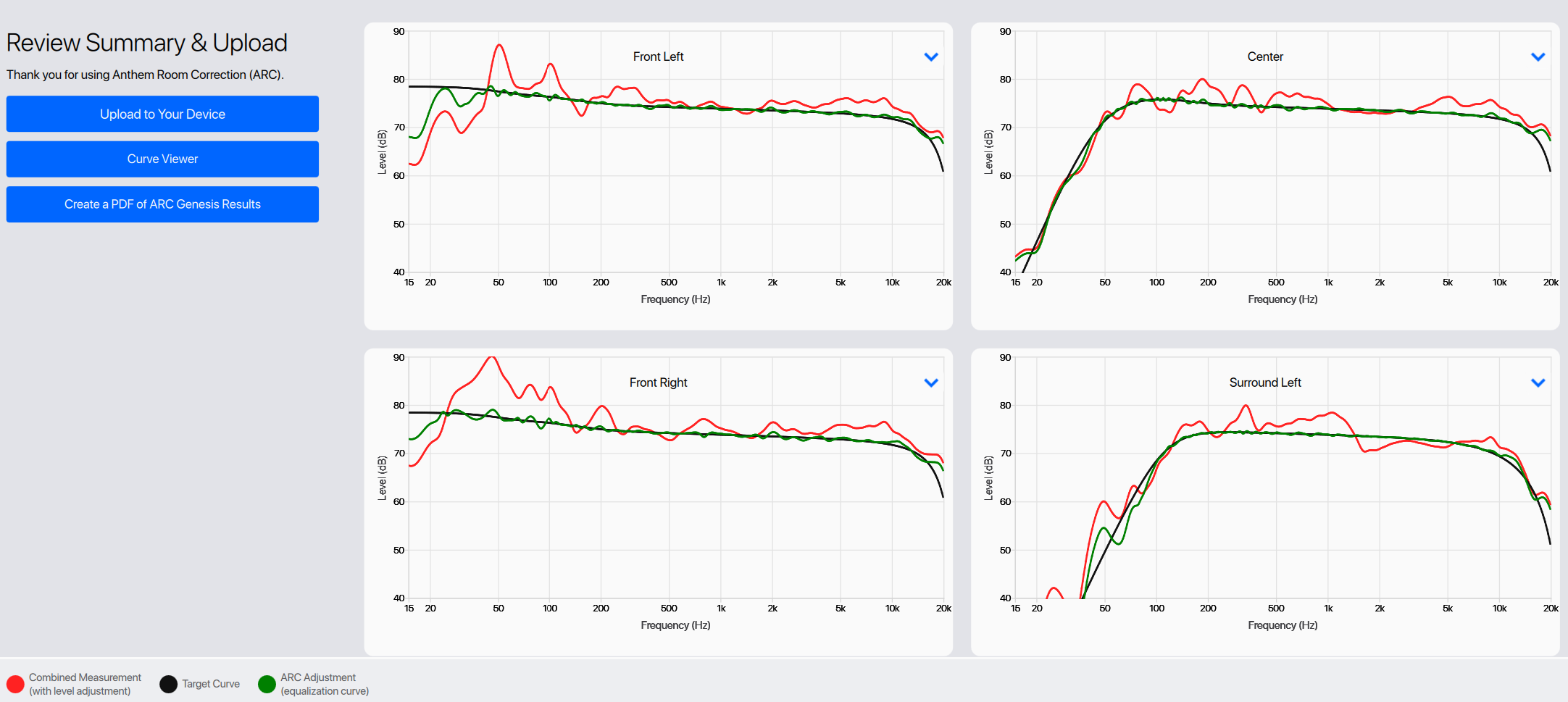

Here are my actual measurements and corrections in ARC
That's great supplementary info! Since you do have the help from RC, you most likely can fix the high frequency harshness, at least to some extent if not completely.
Just that with Anthem ARC Genesis, your option is a little more limited than if it is Audyssey or Dirac Live.
Those predicted FR curves (the green ones) are just predicted, not "actual" measurements for the FR after ARCG calibration.
Still, the red curves, that does represent the "actual" as measured by the mic, show the potential issue you are dealing with.
It looks like you should try the following:
- Increase the HF roll off setting, probably try it with the maximum setting first, such as 0.5 from whatever it is now just to hear the effects and then go from there.
- Increase the maximum correction frequency to 20 K, or 15 K from the default 5 K for the effects to take place.
Again, with Anthem, there are limited tweaks you can do to the target curves, but you should still be able to tame the HF a little. Other than that, I would still suggest you don't toe in the speakers at all.
Also, Anthem does keep the room gain in the bass range, but it seems to apply no deep bass boost by default. If you do use REW, I would suggest you take your own measurements instead of relying on the ARC generated FR graphs. If you do see a suck out in the deep bass, you can then add deep bass, or just do it regardless. Try 3.5 to start, and center frequency 50 Hz. If you feel you have enough bass then obviously just leave it alone, especially if you don't have REW to guide you.
The reason I mention the bass range is that if it is too thin in your room, it might contribute to the feeling of having too much in the high frequency range because the overall response is not on the neutral/balance side of the equation.
That helps a lot!
The fact that what i see in ARC is predicted and not the actual curve post calibration.
I will have to measure manually and see how it looks.
Agreed, that's why I mentioned "for those sensitive to the 12 to 18 kHz range, "...
The OP might just happen to have very sensitive to that range! Some people could be, regardless of age (up to a point, obviously). It is not just the fundamental frequency, the worst case I would imagine is that, he might be picking up the harmonics, especially the odd ones such as 3rd through 7th harmonics of the lower fundamental frequencies. It would/could be worse because those harmonics are resulted from "distortions" to begin with, so it would take a lot less for them to be perceived as harshness. That's just my theory, in order to be sure it would have to be calculated and/or measured.
