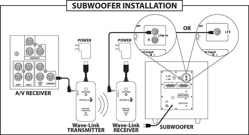

Please check this out and see if you notice any issues.
The above is the Wave-link system I linked to earlier in this thread. Please check this out and see if there will be issues or you think it's a bad idea. I'm just now discovering/researching the issues with delay/latency when dealing with devices like this. I'm learning plenty through this process. I'm trying to find latency specs on this set up now but not doing so well so far.
I appreciate any input anyone has on this setup I'm trying to put together. I see some people don't care for the Samsung soundbar but I can get one for a little over 300 bux and it seems like a decent soundbar as long as I add my sub. Thanks.
What about the HDMI out on that soundbar? Isn't there a way for me to utilize that?

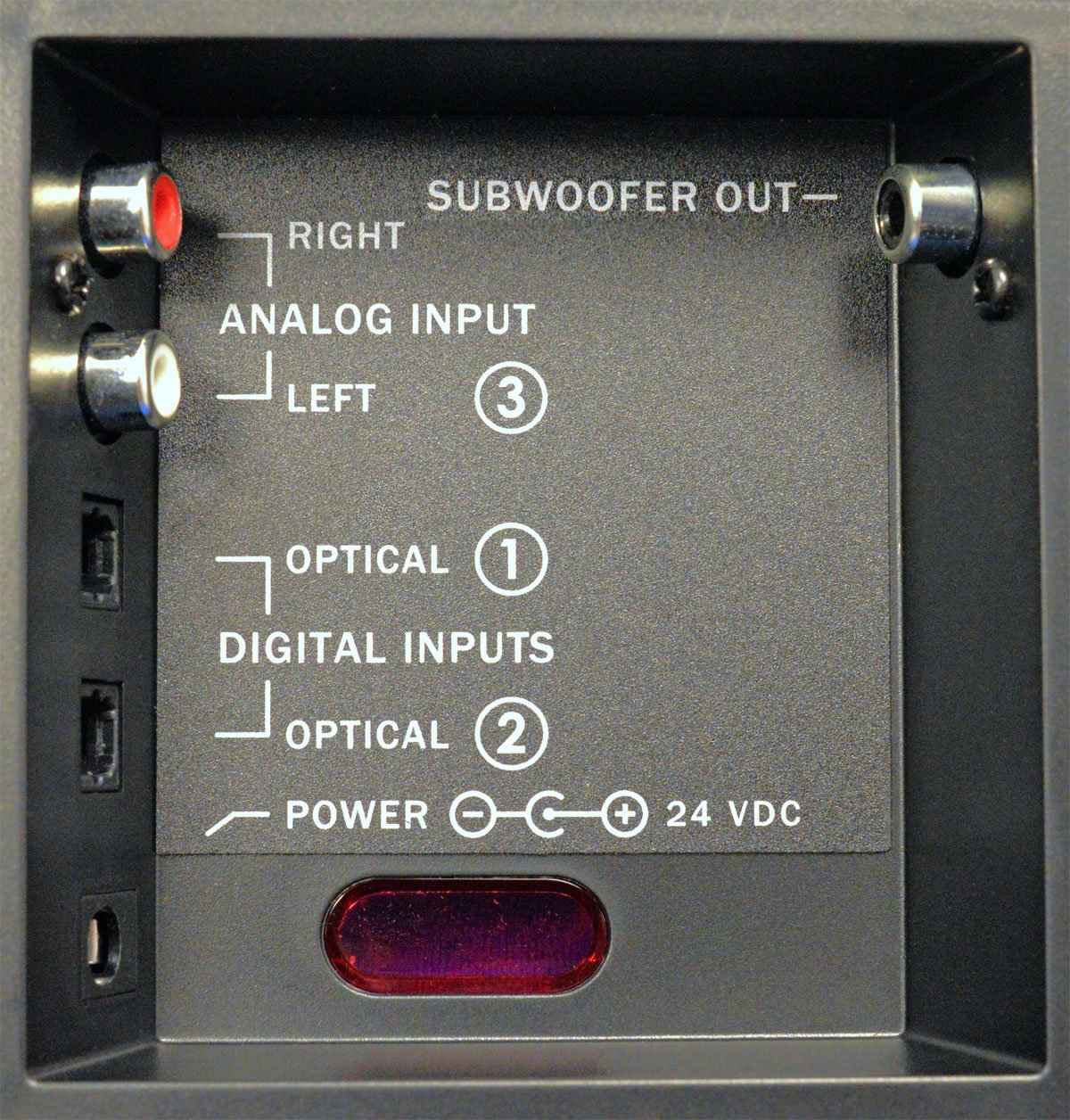

I don't see a sub out on this Zvox you mentioned.
TerriersDad
Disregard above pic (previous post) of the Zvox.... I got that pic from the Zvox site, but then saw the pic below representing the same Zvox SB500 soundbar from Amazon. (the link you posted) Ok, this seems like a good soundbar for the money as well. If I plug a sub into the sub out, is there a built in crossover and if so, at what frequency will it pass to the sub?
