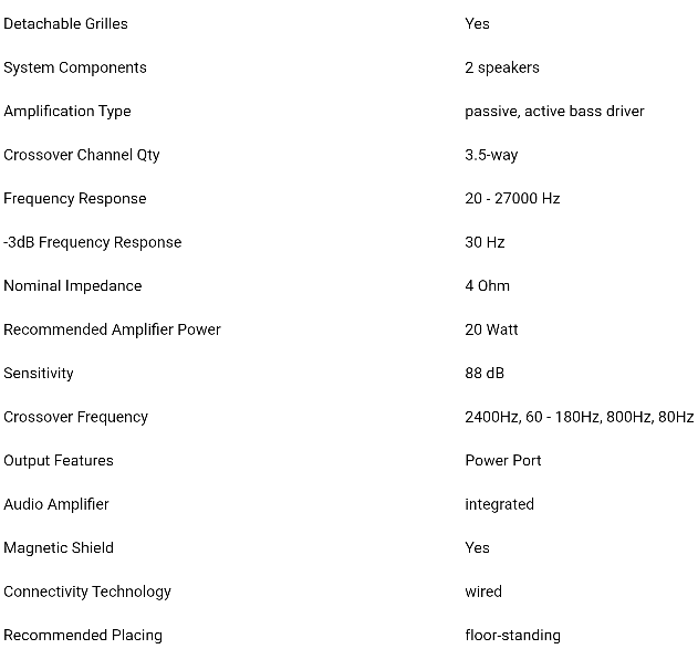

I just found some info on Crutchfield and took a screenie...
I think it worthy to note that the "Recommended Amplifier Power" is only 20 watts... lol.
I see what you're saying about the 80 hz crossover and being confused, 'cuz I am now too... :oops:
*Edit: One of the crossover specs is "60-180Hz"... ? Dafuq?
I hate relying on a retailer's spec. That breakdown of crossover is even more confusing now :)

They way I see is 2400hz to the tweeter, upper mid 800, 60 hz lower mid and 80hz woofer. As stated not well designed, but it does sound good.
FWIW the manual says:
CROSSOVER FREQUENCY:
80Hz, 800Hz, 2.4k
CROSSOVER SLOPE:
Driver: 2rd Order HP, 2nd Order LP, cascaded
Tweeter: 3rd Order HP
