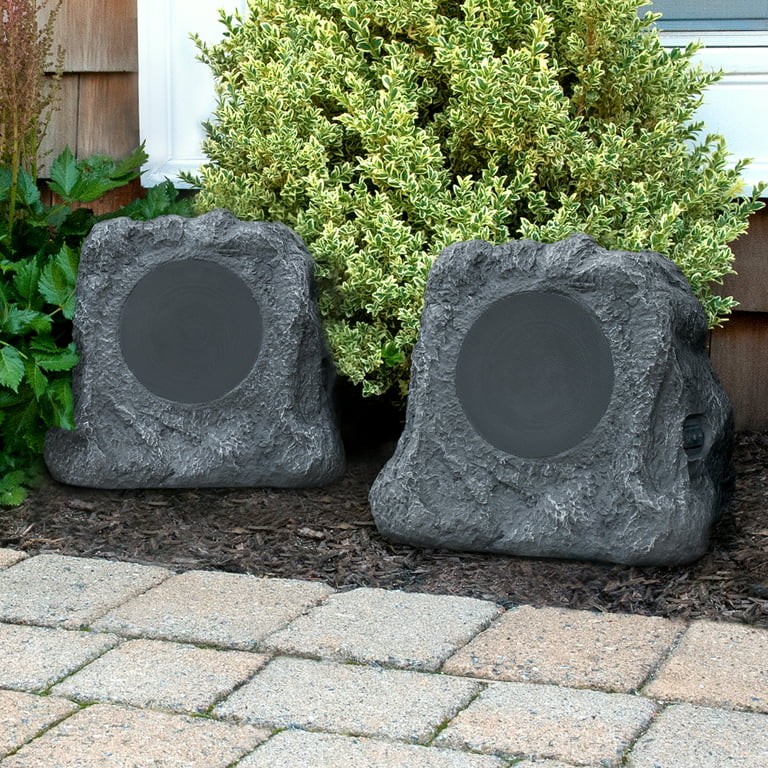

I think they are talking about actual rock speakers here.

Never though, but your right! Just did a look see all kinds of rock speakers even Bluetooth with solar powered panels on them. I just may pick one or two up, The Bluetooth kind, so when Halloween comes around I could play some scary music when trick or treaters come around. :eek: No but really I do sit outside so yeah, I can dig it.

The ones I got from Best Buy look like that. They were so cheap I couldn’t say no (like I ever could to equipment). They have the main rock with the sub and the 2 satellites each with a tweeter and midrange are wired off the subrock (need new jargon for this stuff). So I need to run all 4 wires, the R and L speaker cables to the subrock. Will be powering with my old Yamaha AVR situated indoors with the wires running outside. Bought single 4 line cable that can be buried. It’s a summer project once the summer house is ready for equipment. It still needs a lot of work. Will post once it’s setup. My family think I’m crazy but it takes up all of my time.

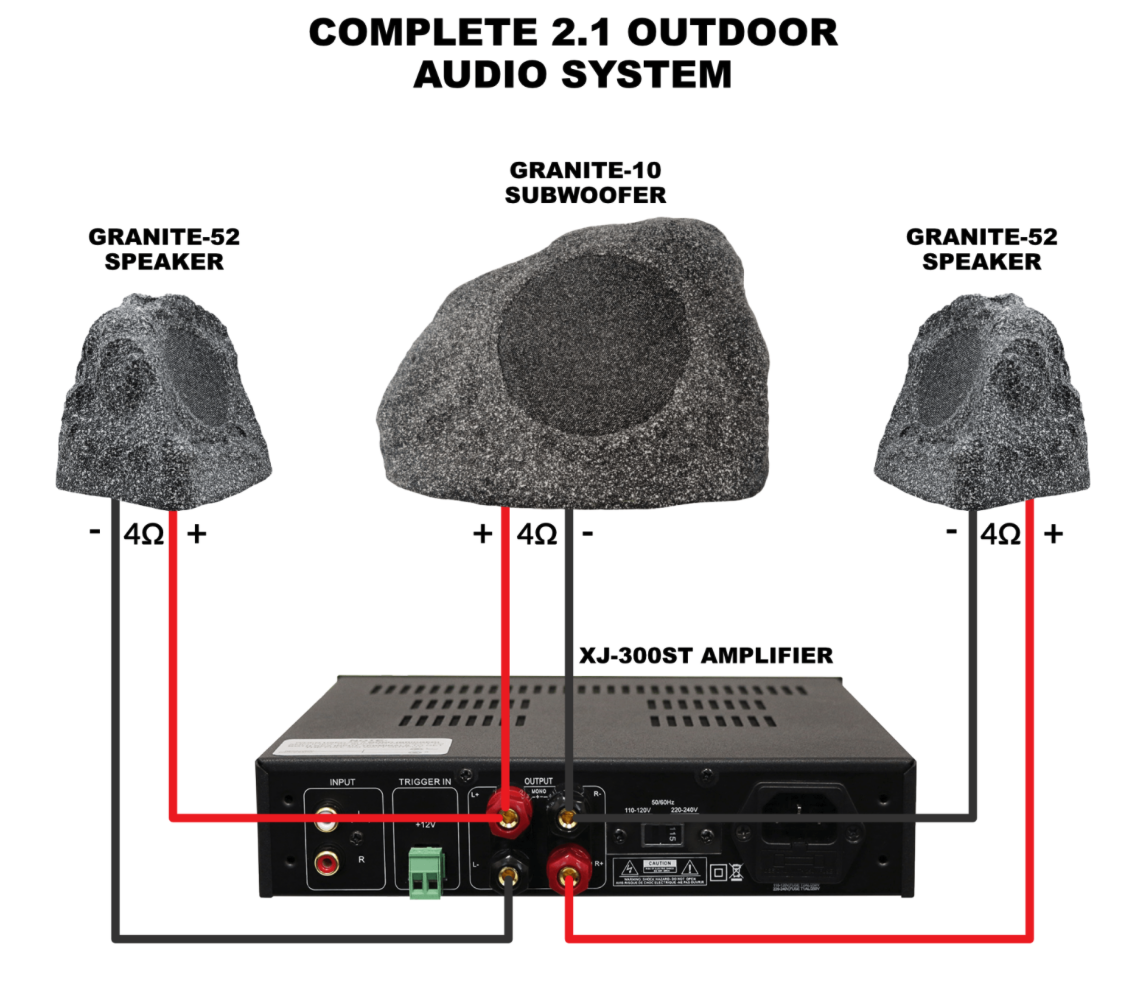

Can you drive them? Yes, and no. Your subwoofer will need a matching amplifier to drive it properly with a crossover designed for it, or it may have an internal passive crossover to deal with the audio frequencies on it's own. Not sure what speaker you have, but generally subs need a fair bit of power.
With a speaker selector, I wouldn't expect much in the way of power that will be going to the speakers either.
It would be helpful if you would list the equipment you have. If you do NOT have the equipment yet, then it would be good to let us know what you are looking at/considering and tell us that.
Frankly, it seems like you have all bunch of gear already and are now asking for help on setting it up, and it may very well be completely the wrong stuff.
I would have picked up a nice multi-channel amplifier from Craigslist that is outdated (no HDMI), but plenty powerful enough to drive all the speakers at once (except the subwoofer), and picked up a dedicated subwoofer amplifier. Then I would have hooked up a product like a Wiim Pro to it and called it a day.

This is outdoor background audio. Not studio listening. Rock speakers do a perfectly fine job for fill audio in an outdoor setting where they can blend with the environment. Some are better than others and most designs can last 10+ years outside, directly in the elements before they start to run into issues. It's like anything else, there is just a need for a solution, and this is one of them. Direct burial speakers are also sometimes used and they do an okay job when people really want to hide things.
