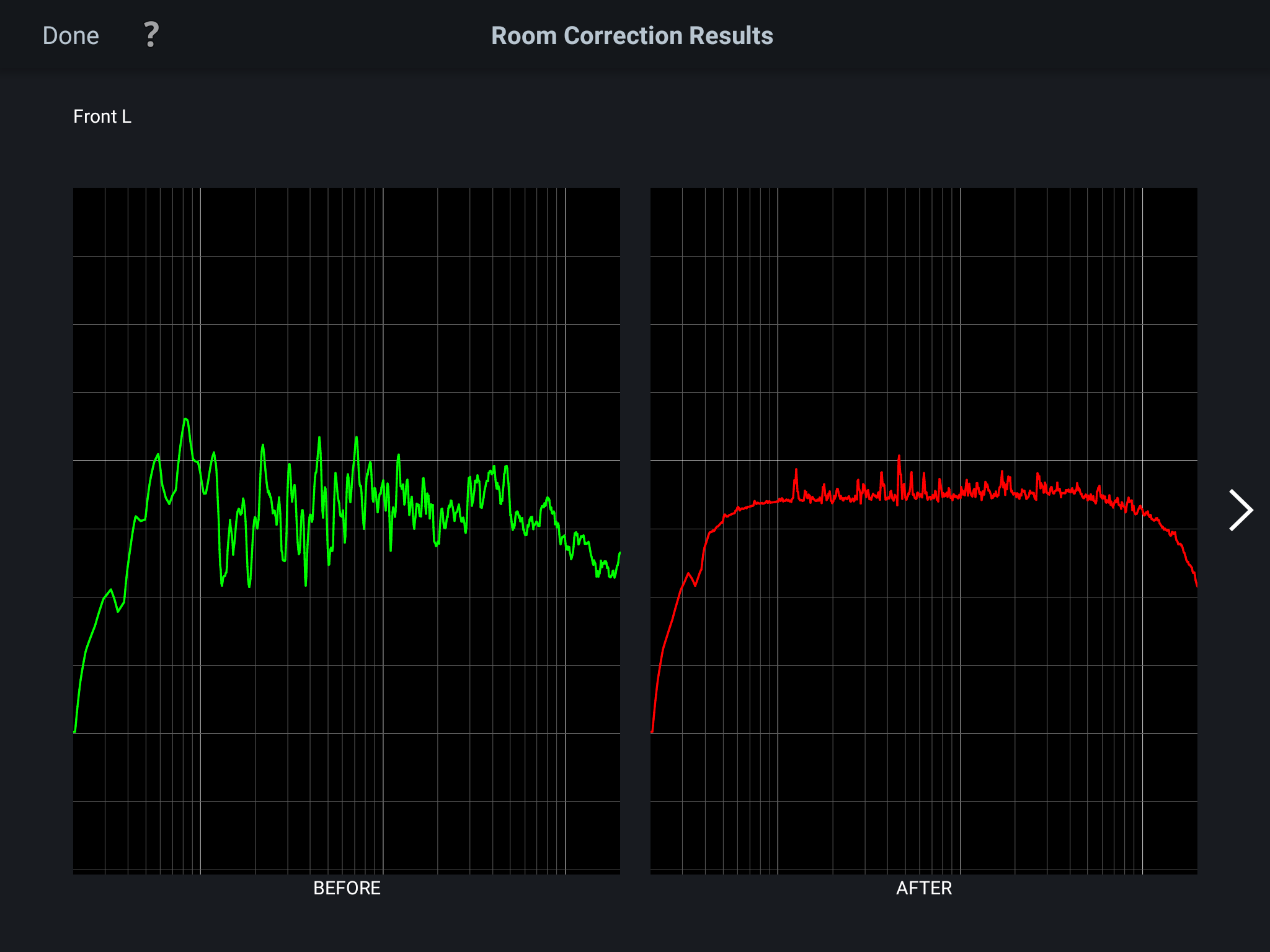

I tried running the app on an older Android phone and it didn't work consistently. But I tried it on a newer tablet with great results. I didn't do anything special with it except run the sampling remotely and turn off the mid level compensation on the L/C/R speakers. The results are very good. It's nice saving the Audyssey setup to its own file too, so I won't have to re-run it anytime soon.

View attachment 23173 I tried running the app on an older Android phone and it didn't work consistently. But I tried it on a newer tablet with great results. I didn't do anything special with it except run the sampling remotely and turn off the mid level compensation on the L/C/R speakers. The results are very good. It's nice saving the Audyssey setup to its own file too, so I won't have to re-run it anytime soon.
When you get the App does it tell you how to use it? Where can I that information?
It's been awhile but it was pretty straightforward. The app walks you through the room response acquisition, then you can manipulate the results to taste. Once you have curves you're happy with, then upload them to your receiver. There's not much more to it than that.
Thanks. Do you think its worth $20
