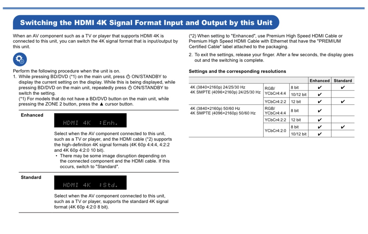

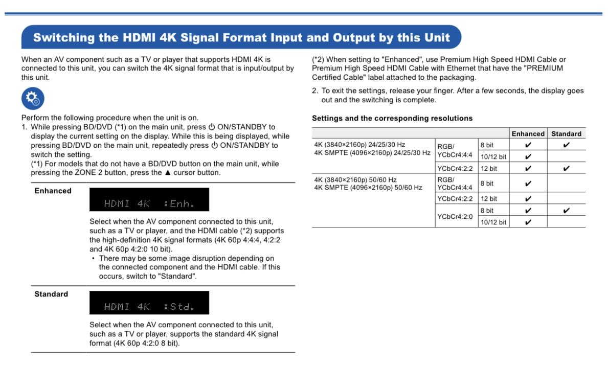

Posted this earlier, but here are the supported resolutions for the Onkyo in Enhanced vs Standard mode. While streaming something from the laptop, press the info button repeatedly on the Onkyo remote control to display the incoming and outgoing signal information. Make sure those HDMI cables are rated at 18gbs or more or blackouts will occur because the 10gbs cables don’t cut it for 4K HDR. Had to replace all of mine a while ago after having blackouts. Hope you work it out.
