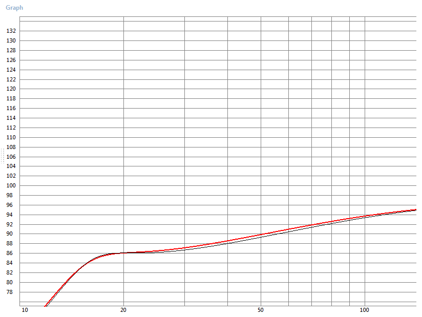

This is the response of the two drivers at precisely 1 watt each in the cab:
B&C 21DS115-4 = black line
B&C 21DS115-8 = red line
The two drivers have essentially the same efficiency, perhaps the 8-ohm has a hair more, but for all practical purposes, the efficiency across the whole bass region is the same.

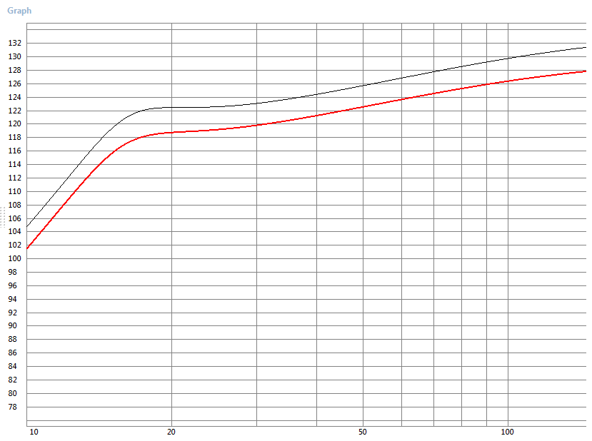

So let’s turn up the gain and see how many watts will each driver attempt to “pull” from the amp?
Using the equation from above W = V^2 ÷ R
B&C 21DS115-4: W = 100^2 ÷ 2.2 = 10,000 ÷ 2.2 = 4,545 watts.
B&C 21DS115-8: W = 100^2 ÷ 5.1 = 10,000 ÷ 2.2 = 1,961 watts.
Assuming that the amp could survive under those conditions, this is the response that would result:
In the model, the 4 ohm driver is pulling a little more than twice the power than the 8-ohm driver, so it would be expected to have a little more than 3dB advantage across the board.
