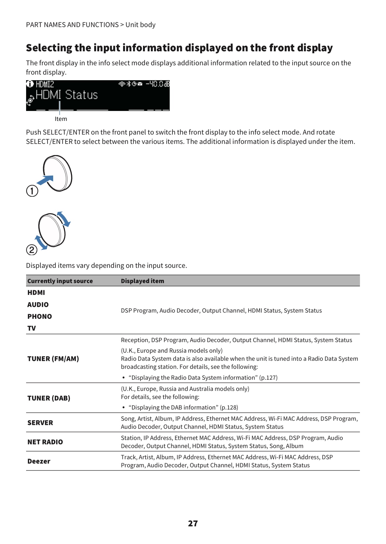

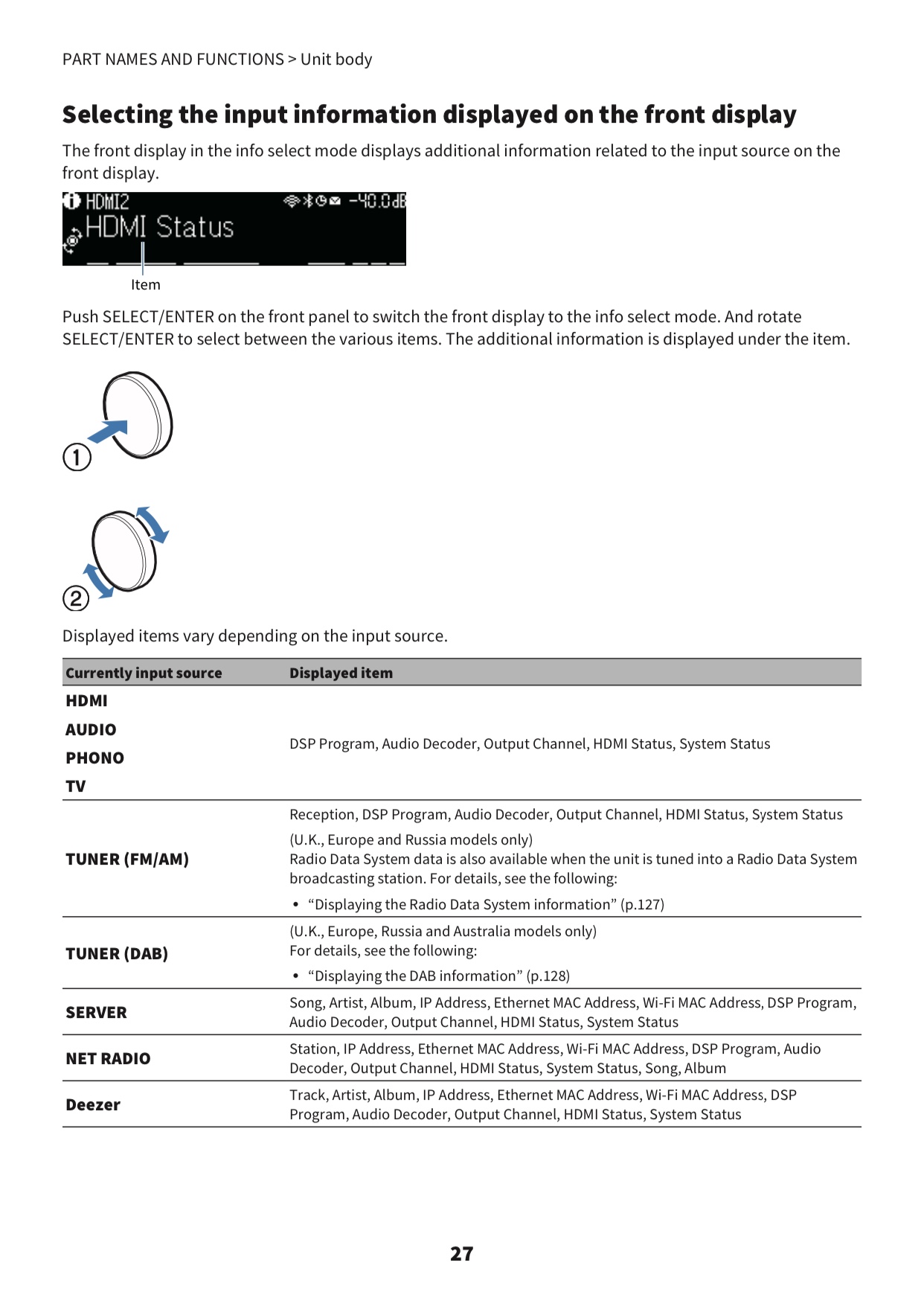

I ended up returning the equipment and exchanged it for the same unit. It now seems to works better from what I can tell. The only thing that has me confused now is the sound decoding.
If I go into options and check out the audio source information while content is playing. It will say, 'Atmos/PCM' but on the receiver it switches to "Straight' on the receiver display. Are the Yamaha's suppose to say the name of the audio on the display of the AV and not just straight or surround decoder?
Here is a video
Trebdp83
You can change the information on the front display to show the audio codec.
