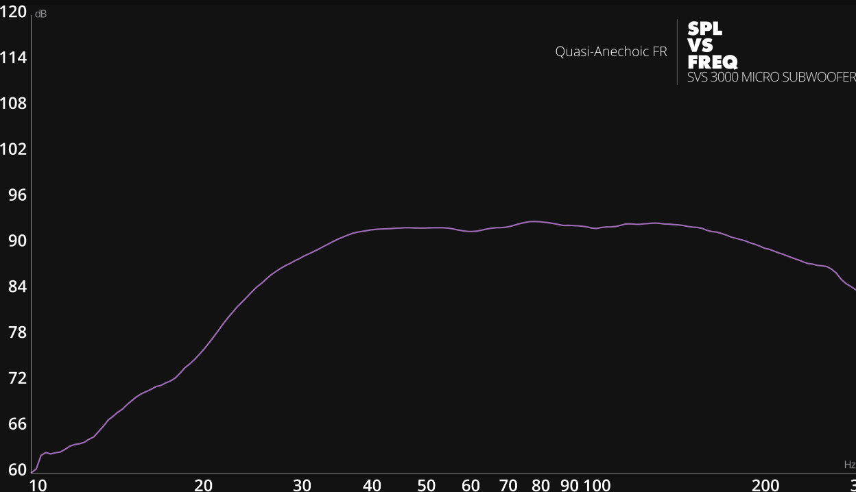

I just received my 3000 micro about 5 days ago. I can say that it has not impressed me. I needed something to replace my Svs sb 1000 with a smaller foot print to appease my wife.... After adjusting crossover, parametric eq, room gain, placement, etc I simply cannot get it to output low freq at an audible level without over producing the higher end of the low freq spectrum. It simply will not do it. The higher freq sound coming from it does not blend well with my paradigm prestige 15b bookshelves. I'm using a Cambridge audio cxa81 integrated with the lfe out to the sub and streaming to the integrated with bluesound node 2i. With the sb 1000 the system is perfect, that sub produces the perfect blend of low freq. In my opinion, the dual opposing drivers prevent the drivers from extending all the way by creating too much pressure inside the cabinet with no port. It's physics. The micro does look slick and worth the money, but the sound is far from it, I'm sincerely disappointed. Hope this helps.

I have the new Micro, and it sucks. I will be returning it. It cannot audibly produce the low frequencies. It over produces the higher end and I can't believe I fell for it. The dual opposing drivers literally prevent the drivers from reaching the deep end. Too much pressure in the cabinet for the drivers to extend. Pure physics. Pure marketing

The measurements on the site alone tell you that. No one is buying this sub expecting loud subterranean bass from it. It's a lifestyle product, not a HT subwoofer and I think they make that pretty clear in the marketing literature.
Good thing they offer such a generous return policy, huh? If you want deep, powerful bass you need a larger ported sub. That's just physics. Sealed, smaller designs are always a compromise. Get a PB2000 or 3000.

No micro subwoofer will reproduce deep bass meaningfully. How the heck is the SB-1000 too big for you? It's a 13" cube! You should probably return your wife, not the sub.

I understand, but 23hrz is advertised and it is a little misleading. I love the svs brand, but just not this sub. Just trying to put my opinion out there for anyone expecting meaningful output down to 23 hrz doesn't make the mistake I did. Thanks

Usable bass doesn't mean flat to 23 hz. I'm looking at the page right now and it's really clear they're not pushing it as a super deep HT sub. They refer to it as a micro sub. All the specs and measurements are right there. If you didn't look at the info provided that's your fault.
That right there tells you almost everything you need to know. This is not a subwoofer you buy if you're looking for deep bass. There's nothing misleading about it.

To be fair, his description of the problem isn't totally off, although I do think he misunderstands the fundamental issue. The more cone there is on the surface of a sealed cabinet, the higher it pushes the system resonant frequency. The Micro 3000 has a pretty high cone/enclosure volume ratio, so that will crank up the midbass efficiency at the expense of deep bass efficiency. You can lower the resonant frequency by making the cones/moving assembly heavier, but that means dramatically lowering mid-bass sensitivity. You can also make the suspension very loose, but that brings in a whole host of other complications.
He is right that the woofers are creating a higher internal pressure that is reducing deep-bass output, but he is wrong to attribute that to the dual-opposed driver configuration specifically.
