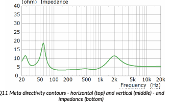

Doesn't look like a difficult impedance curve, to me.

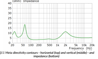

That curve is from KEF's literature. The impedance is 4 ohms or less from 100 Hz to 700 Hz, which is the real powerband. I suspect that curve is smoothed as it does not show the 3.2 ohm dip in the specs from KEF. Also I can not find phase angles anywhere. That is really crucial in assessing what amp you need.
I will have to get my measurements. If it is not bad I can loan him a Quad 405-2 which is stable to four ohms. I do have a couple of Quad 303s that are 45 watt per channel and designed in the sixties. They are unconditionally stable under all loads. The only amp I know of that can claim that, and the claim is true. You can even connect the speaker outputs together on those without blowing them up. They are the most bullet proof amps ever designed and by a big margin.
