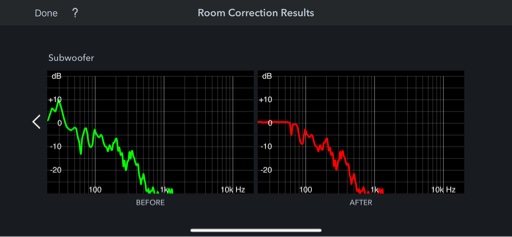

Audyssey puts the calibration at -20 DB on subs and -5.0 dB on the receiver.

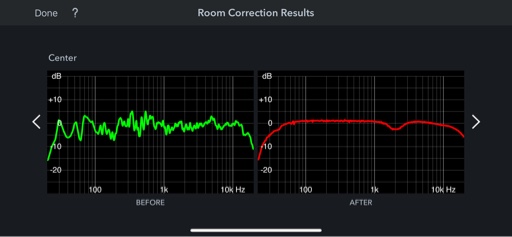

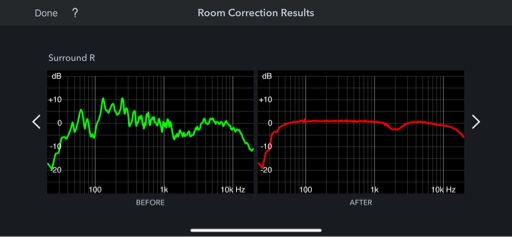

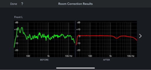

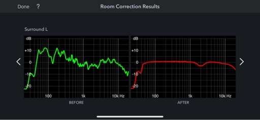

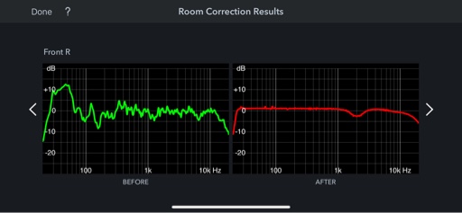

Just ran some correction through Audyssey app. What do you guys think?
E
elitex
Just for reference this room is just under 22 X 17 Ft.
