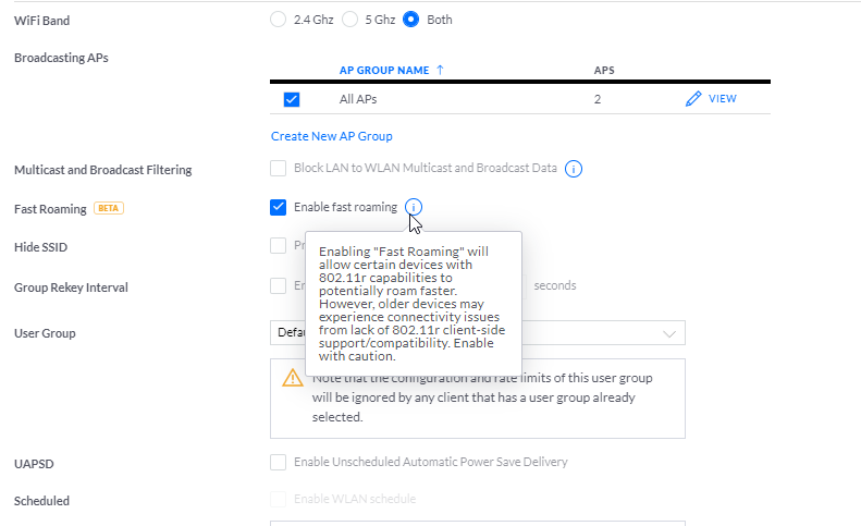

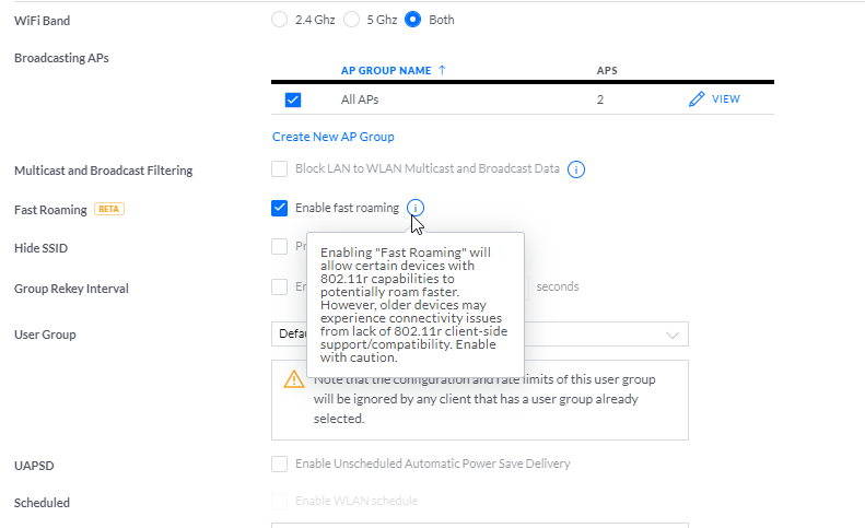

You need to make sure that 802.11k/v/r is turned on.
I do, or what Unifi calls it. "Fast roaming" is enabled. After using Sophos, I still feel the Unifi stuff doesn't let you customize enough settings.

You only have 11r turned on with that option. Perusing the Unifi community, and it affirms my choice to use TP-LINK, is that it's clear as mud as to what standards they support, how to access them, and get it all working reliably.
Also note 'Beta'. Again it's why I don't use Unifi. They are like Zebra Stripe gum IMO.
