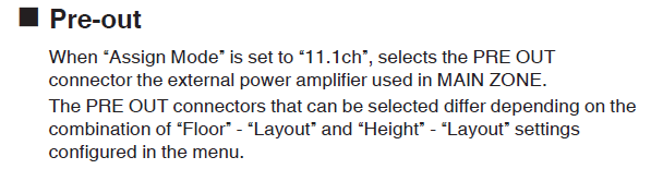

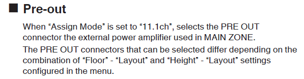

FL and FR are only disconnected to the FL and FR channel power amps if and when you assign them to other power amp channels such as the height channels. The Owner's manuals are not very clear. For example, for the SR6012, SR7012, AVR-X4400H it says:
Exactly the same for the AVR-X3600H as described in the Owner's manual page 217.

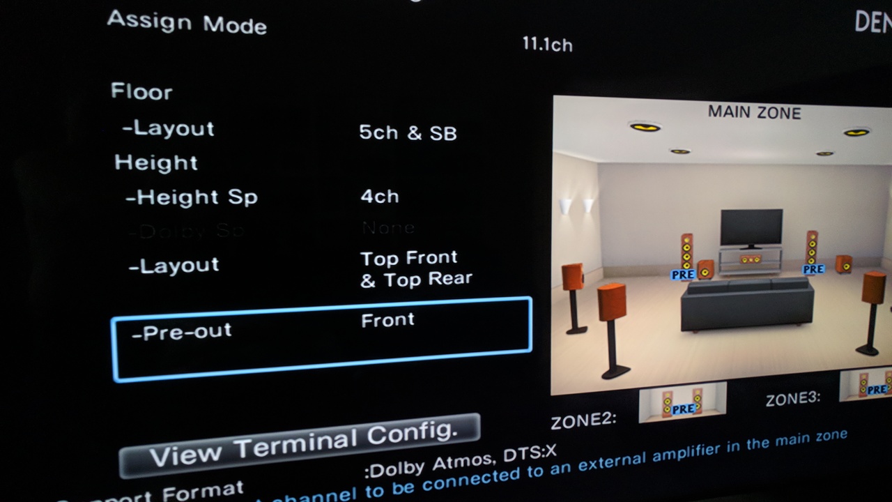

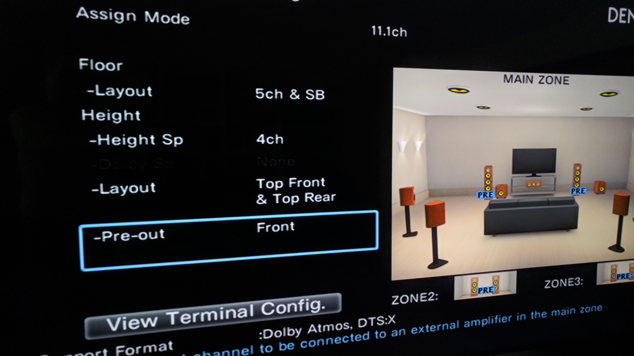

Here's a screenshot I posted before:
I understand what Gene was suggesting, that he thought at higher pre out voltage such as above 1.5 V or so, the power amp output voltage may clip, thereby resulted in more distortions in the pre-outs, but I am not sure if the effects is really significant enough for most users to be concerned about. It would be great if in his next review, he picked something like the X3600H, or a Marantz SR6013/6013, and measure the pre-out distortions on the FR/FL channels, with and without the FR/FL disconnected so we can actually see how bad/or not the effects really are. The other thing is, at higher pre out level, the unit would shut down when he did his FBW continuous sweep, but for real world use that won't likely be an issue.
