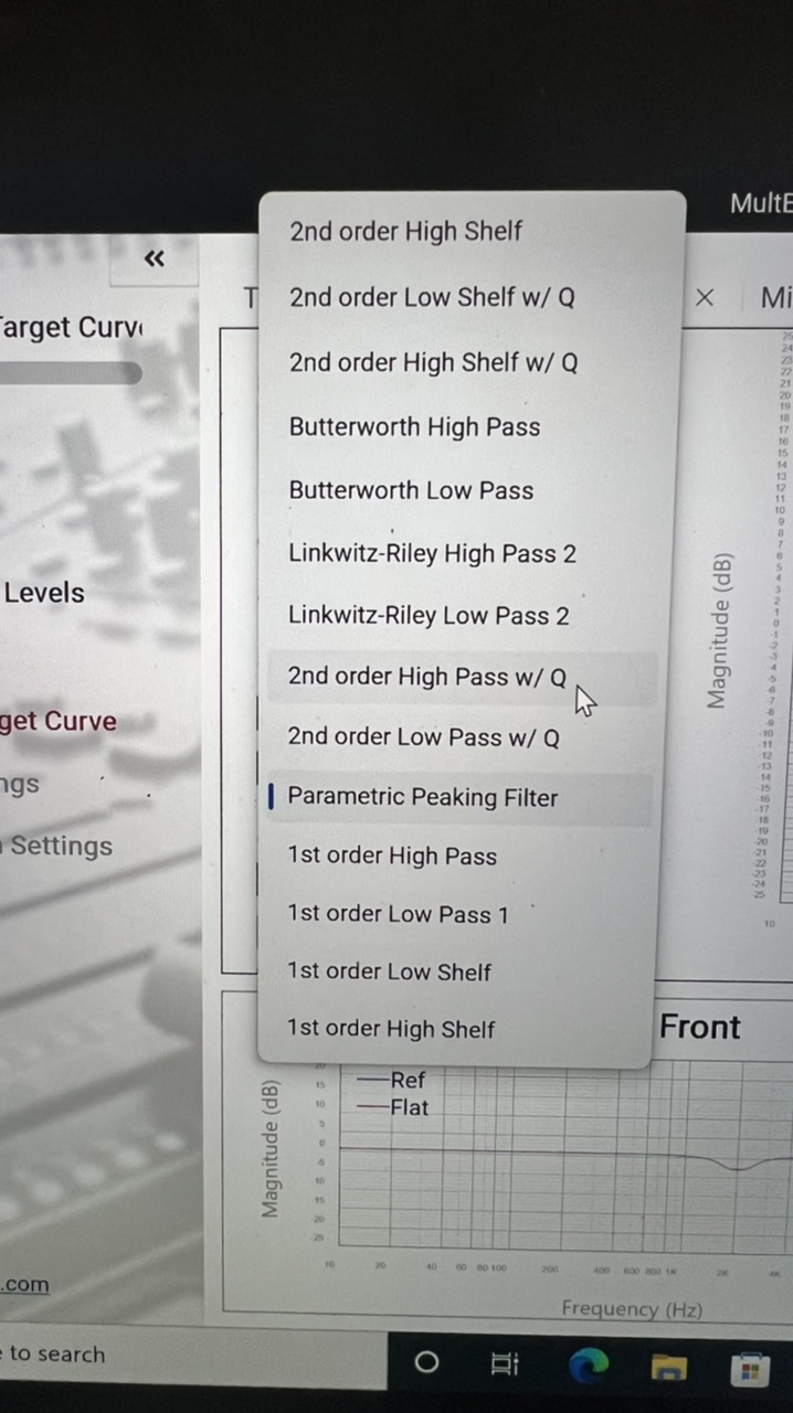

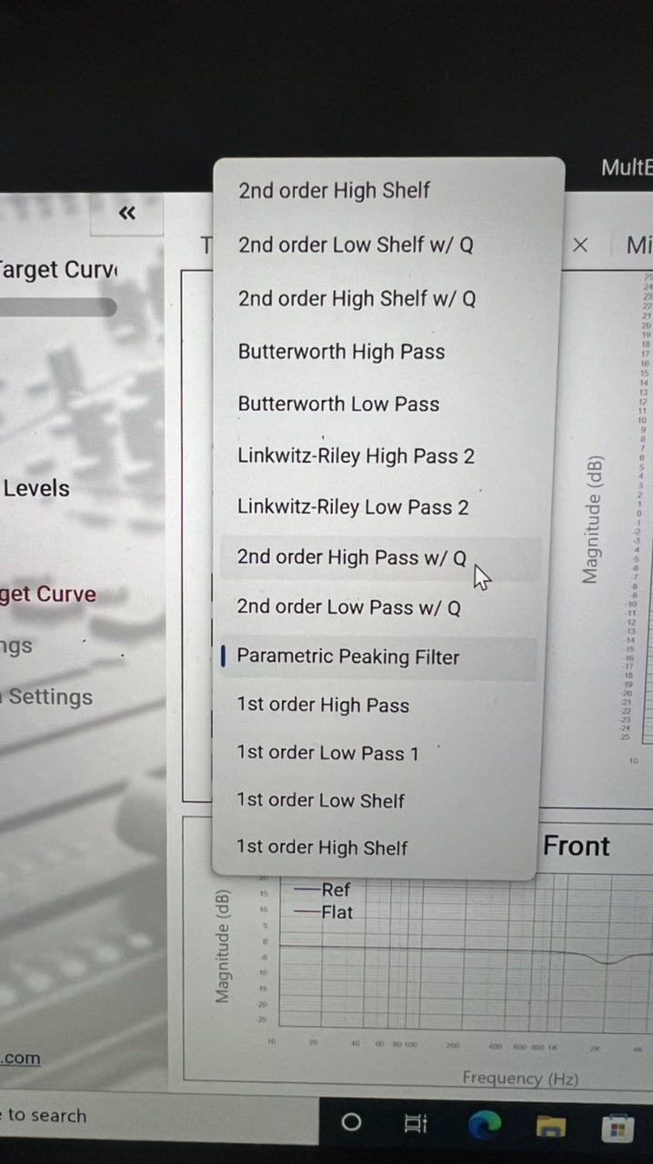

Correct you choose the type of filter and enter it hereView attachment 52509
Thank you, that's nice. Rat doesn't have that but then it is just a data entry tool, i.e. typing data in vs drawing with a touch pen. So the App probably also use PEQ and select "Q" based as well as which types of PEQ filters it sees fit, or use a different way other than PEQ. Once you have the final curve it would great if you could compare the one with the best the App+Rat could do. For me, App+Rat got me +/- 1 dB from 16 to 125 Hz, 1/12 smoothing, but that's a few hours work.
