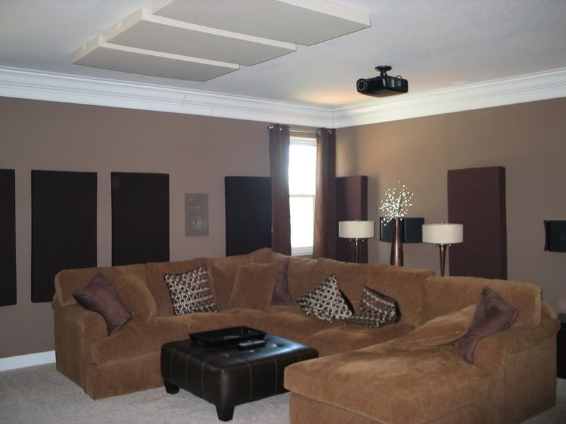

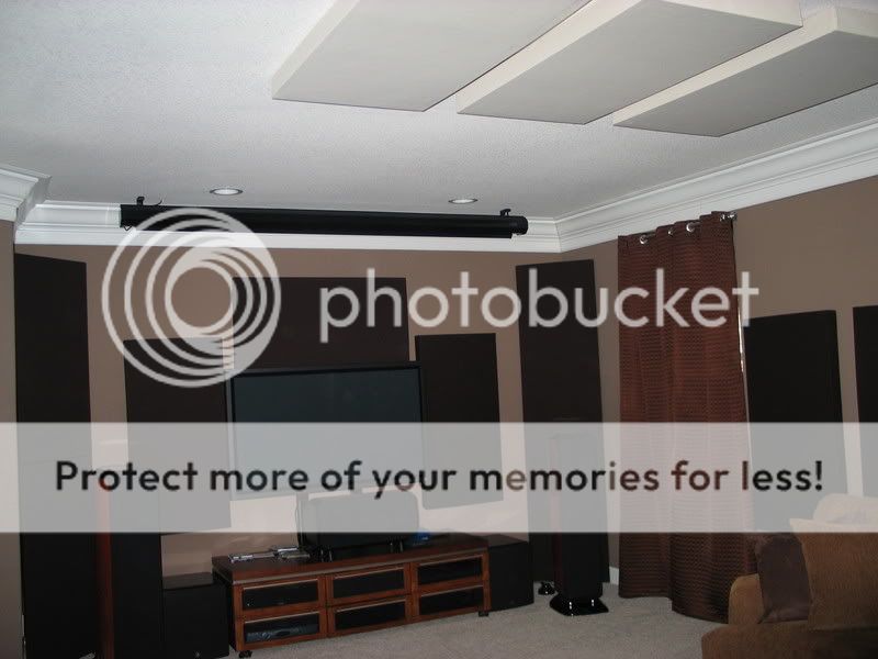

Now that I have the speakers and electronics where I want them, I’ve been turning my attention back to the room. The initial deployment of acoustic panels was a little shoot from the hip (even for me). I have been giving this more thought and also spoke with Frank @ GIK and will be adding some bass traps and treat the first reflection on the ceiling with some more absorption panels.
I have been trying to use equalization to get the room right but have been disappointed after numerous attempts using the Audyssey Multi EQ (Integra 9.8 version). Audyssey make the room sound flat and dead.
I really want to be able to tame the bass frequencies a bit as I believe that will improve the performance of the midbass and higher frequencies. Of course, this is all just speculation but hey… it’s my hobby;).

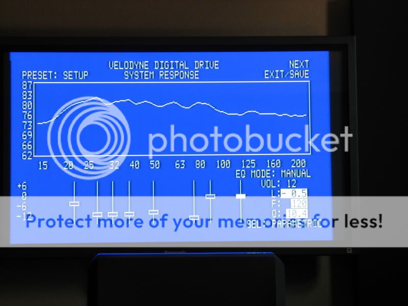

Added some 4" "bass trap" panels to the back walls and ran some more SMS-1 FR sweeps. Similar results to prior to the addition of the bass trap panels. I little more uniform across the full width of the seating area. I am somewhat limited by the in/on-wall SS speaker positions and the actual wall surfaces themselves due to the room being odd shaped. Here are a couple of pictures including a new SMS-1 FR graph. Ceiling panels for the first reflections are next.
The panels:
The graph:
mike c
mike c
don't you have a bit of extra headroom? why not a boost or two at the low end? (unless the JL's have a subsonic filter)
what subsonic filter did you set the SMS-1 to?
rmk
rmk
I have the SMS-1 Subsonic off.
Thats an interesting idea:). I'm going to have next weekend alone and I'm planning nothing but playing with the system. I might try a little boost at the 18-20 Hz area.

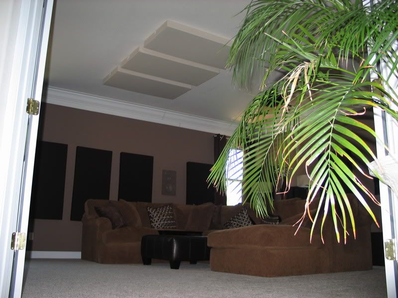

GIK Acoustics
I installed three ceiling 2’X4’ Acoustic Panels last night in what should be my last room acoustical treatment. I listened to a lot of music and watched a couple of movies last night and the difference is noticeable. Killing the first reflection points of my mains and CC has really improved the clarity of vocals and instrument separation. With the added bass traps, the bass is better than ever and the in room FR is now very flat but the bass still has plenty of slam when appropriate. The room still has life left in it but it is definitely not the large echo chamber I had become accustomed to in my old room.
I would still like to have an acoustician take detailed measurements in the room to see exactly where it is at but overall I’m pleased with the results.
BTW, GIK was very nice to exchange three unused of my wall panels for the new off white ceiling panels. They have been a big help in getting the room right acoustically.

I have a couple unused 2x4 ATS panels left over so I think I'll have to give that a try with them on the ceiling like that.

Thanks Mike but I wouldn’t mind a do over myself. Personally, I think I may have gone a little over the top with the treatments. It is looking a bit like a Recording Studio and I need to work on the esthetics. I’m thinking of framing the Panels to give them a more finished look. Also, the sectional couch is great for lounging around or reading a book and listening to music but for movies or critical listening, I’m wishing I had a more traditional HT seating arraignment. Maybe it’s my size (I’m 6’6”) but it’s just not that comfortable to watch a two hour movie on the couch.
The good news is that the systems audio is now as good as I have heard and I’m able to turn my attention to other details that I should have considered before I built out this room. This has been a “ready, fire, aim” project from the beginning and the hindsight view is always much clearer;).
rmk
rmk
Good idea Matt, you'll need a helper to hold a mirror up on the ceiling to determine the first reflection point from the seating position. Once you can see the speakers front baffle in the mirror, that's the spot.
Mounting them is a beaach (easy two person job but I did it solo). I used small L brackets and then painted them to match but I still see them even if others don't. I'm going to frame the panels and that will hide the bracket mounts.
Matt34
Matt34
Moderator
I have cathedral style ceilings with the slope going up towards the front side of the room (8' to 12' approx) so I might even see a more noticeable difference than you did. Like you said though, going to need some help hanging them that is for sure.

Thanks Phil, just looked at the pictures above again and the dead palm fronds really look bad. Nothing like a dead plant to frame a picture:eek::p.
I'm at a pretty good place right now as the room sounds better than it looks. Cosmetic issues are much easier to fix;). My hope is that I don't get as anal about the video as I have been with the audio:eek::).
