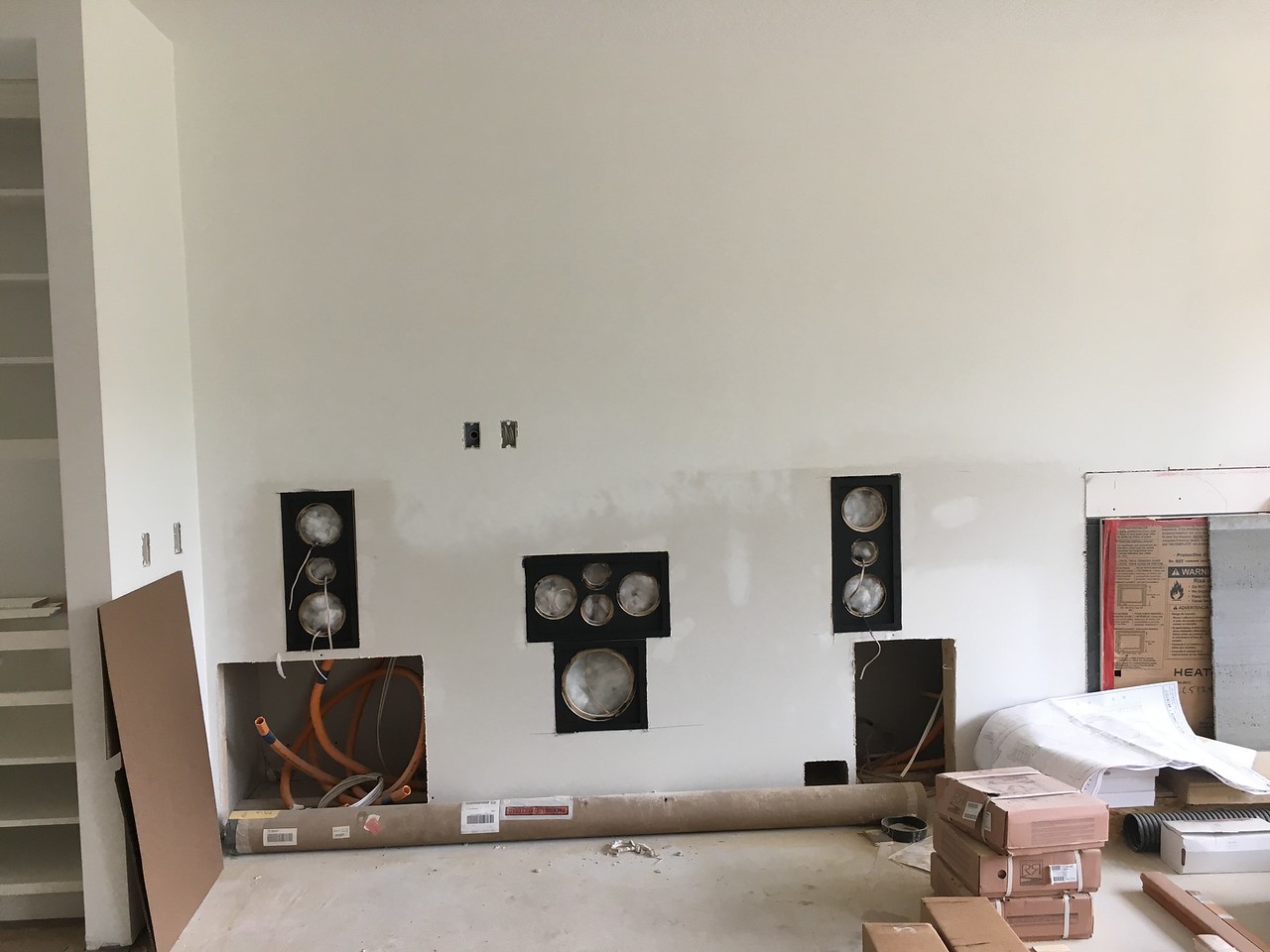

Fans installed in the Left cabinet of the downstairs in wall system.
Set up as of yesterday. Both cabinets put in today and ready for equipment installation.

The in wall system in the lower great room is finished. I have given it a listen and the family had the Vikings game on yesterday. I have not done any set up other than by ear.
However the right and left mans sound very good. They are powerful and easily fill the space. They may be slightly over polite and need the tweeters brought up a fraction. That is a very good starting point.
The center has superb voice clarity, even at low volume. There is no overt shout or sibilance. However I have a feeling that the mid range driver may need taking down a notch, we will see.
The TL sub with the 10" Dayton driver is a real keeper. This is a huge space and yet this sub filled the space with deep tight pure bass without distress. This is a huge space and is fully open going up the stairs. I walked around the space and the bass was very uniform throughout, without any high or low spots.
