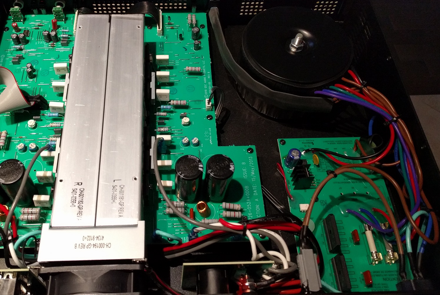

I've just perused the owner's manual for the RMX850a. It would have one circuit breaker for each channel -No fuse. :)
But it looks like tthe DCA series amps don't have any fuse or breaker. I read the troubleshooting section in the owner's manual and there's no mention whatsoever about a fuse or circuit breaker in the text, and there's no circuit breaker switch at the back of my amps. I assume that their protection circuits are adequate to prevent extensive damage should a malfunction occur.
In that case that would be one difference between the 850 and 850a.
I don't have the service manual for the 850a so I based my comments on the 850.
Also, I thought I saw the fuses when I had my 850a opened for the fan swap. I am going to review the photos to see if the breakers were captured.
Edit: Okay, I remember right about seeing the fuses, found the photo. The breakers for for the transformer primary protection, the fuses are on the transformer secondary, to protect the rectifier bridges. You can see the 2 fuses in the bottom right corner.
Those fuses on the secondaries are more likely to protect a relatively expensive transformer.
Those are a good idea! And, I doubt that many commercial designs do this.
Post #25 on here, you can see my fuses on the t/f secondaries. This is a good design decision, as outlined in the book by G Randy Sloan.
I really suspect that the power supply has a fuse, it is a safety feature. As in the safety of your home and life.
https://forums.audioholics.com/forums/threads/new-chipamp-project-thread.92513/page-2
They obviously do help protect the transformer as well because that's what feeds the rectifiers. The transformer on the primary side of the transformer offers protection against not only overloading (only severe overloading), but also short circuit on the secondary side, even if the short is on the upstream side of the fuses. Anyway it is always good to have protection on both side of the transformer.

This is a nice construction which is definitely not crammed like components in today's surround AVRs.
By the way, I assume that all the circuit boards on this RMX850a are installed upside down to prevent dust to accumulate on the components and boards as with my DCA amps.
I'm not familiar with these amps, but I assume if the boards are mounted upside down they have a fan, correct?

Yes, they do. What a bright design!
Then the reason for the upside-down boards is probably to put the active components in the airflow, not to prevent dust build-up. If they're worried about dust the fan would be filtered.
If you look carefully at the photo which Peng posted above, you will see that the boards are not in the air flow. The cooling fan pushes air from the back to the front, in an aluminum tunnel formed by two joined heatsinks at the center of the chassis. :)
