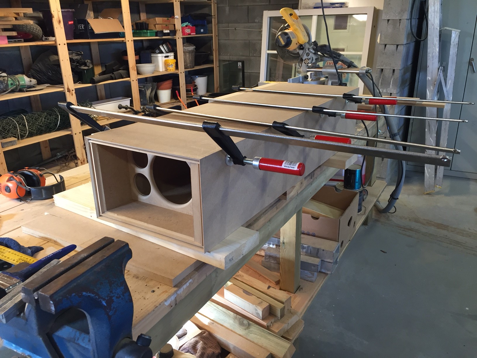

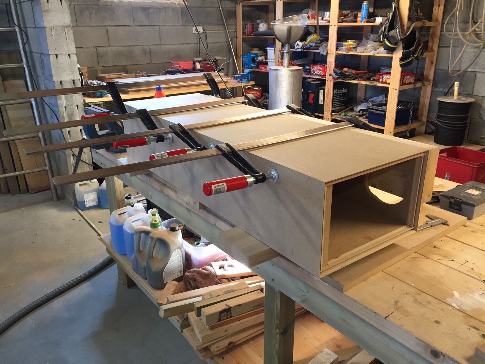

Roadrune, I'm interested in what you're using for a router bit on the mitered corners. I think I know what's going on but I don't think I've ever seen that method of joinery in action. Nice going.
Alex2507
Alex2507
It was a PITA to set up
I spend way too much time thinking about that joint. No pun/s. That has to be the ugliest cloud of MDF dust ever but locking a miter like that would be a dream come true for me.
I have the perfect project for that bit. ;)
R
roadrune
Once its set, its a great joint. If you are going to use, check out the videos on youtube, helps a lot:)

Hi, i use this bit http://www.precisionbits.com/lock-miter-router-bit-45-degree-large-yonico-15122.html
It was a PITA to set up, but offcourse youtube could help :)
I always was told that bits like that work poorly with MDF. They apparently work well with plywood or hardwood. I've never tried them. Do they require a router table?

I would say the lock miter bit need a table, you could do it with a side fence but it would be realle difficult.
I see what you mean with mdf, couse the edge following the thickness of the plate is really fragile, but if you are careful its ok. Once its glued its strong as hell.
