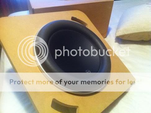

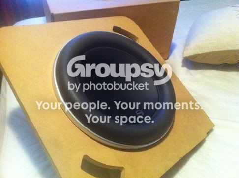

I've never heard of arucoply. What is it? What are the benefits of using it? Good luck with the build. Be sure to keep everyone posted on progress. Like you, I hoped that this would be my last build too. For mains, I think they are. My craving to build other speakers hasn't gone away but I now get to build for friends and family (although I will be building some subs in my near future :D).
(shhh, don't tell the wife but there's one more of these bad boys coming)

PS: That woofer looks great ... what is it? Specs?
