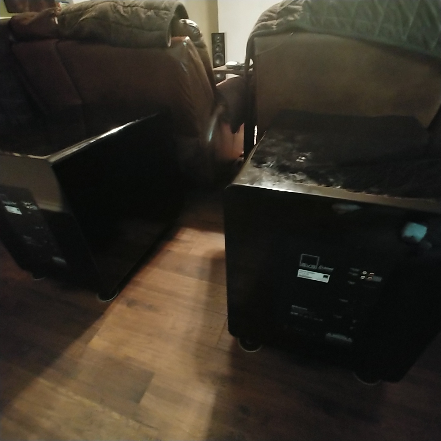

Well boys you guys know I'm a bassaholic so I thought about it.... And decided...... F@$! it I'm going for the Near field effect! I'll let you know how it pans out fellas

Ok fellas I'm just going to say after calibration with both subs Near field behind the couches? Here's my official review.
HOLY FRIGGIN AWESOMEBALLS BATMAN WHY DIDNT I THINK OF THAT BEFORE! THAT SOUNDS FRIGGIN EPIC!!!!!!!
Problem solved my bass has never sounded better my life has been made complete. It sounds and feels so good I feel like I smoked a bowl. Literally I feel high on sound right now. And I have both subs on -20 dude that's unreal. The plates don't even get warm on the amps. Man this is gonna help my subs last for a long long long time
Shady you're always saying your bass in your room when your measuring subs is right behind your chair. You sly dog you you sneaky devil all this time you got to experience what I just felt.
Ahhhhhhhhhhhhhhhhh I LIKE NEARFIELD. o_O

Your welcome! I don't really do it for the far greater tactile sensation though, I just do it because that is the location in my room that just happens to net the best response from a single subwoofer. The extra oomph that comes with the kind of placement is just icing on the cake though. Try listening to some dupstep or dumn'n'bass tunes with that placement with the subs running hot. Here, start with something like this.

This looks like an ideal setup. Sweet! :)
