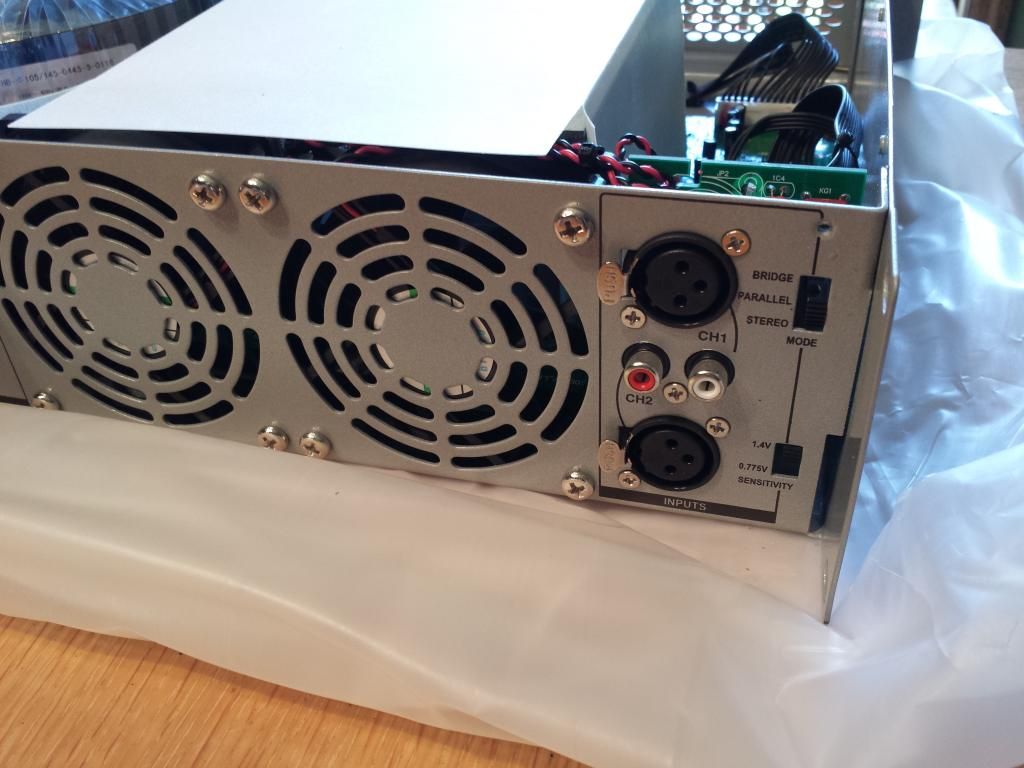

Just as an example of what it means to have the experience/engineering of a company like Harman International, notice how the fans in the Emotiva are blowing air directly into the cooling fins. The air is being rammed into the pockets of the heat sink and there are no vents underneath, so at the bottom there is poor airflow. There is venting above the heat sink, but the air still does not have an ideal free flow past the fins and out of the unit!
Crown shrouds their's for maximum efficiency, so I had a tough time finding an image, but I did find one from one of their earlier entry level models (X1000) courtesy of AVS forum!
Compared to the Emo, these heat sinks are a thing of beauty. You can see how much surface area they expose to the air and how efficiently the fans pull air through the fins in laminar (instead of turbulent) flow!
You can tell that the Crown design had cooling wholly integrated in their design from the outset!
Difficult to beat a 200W x 2Ch amp from Harman for about $200.
