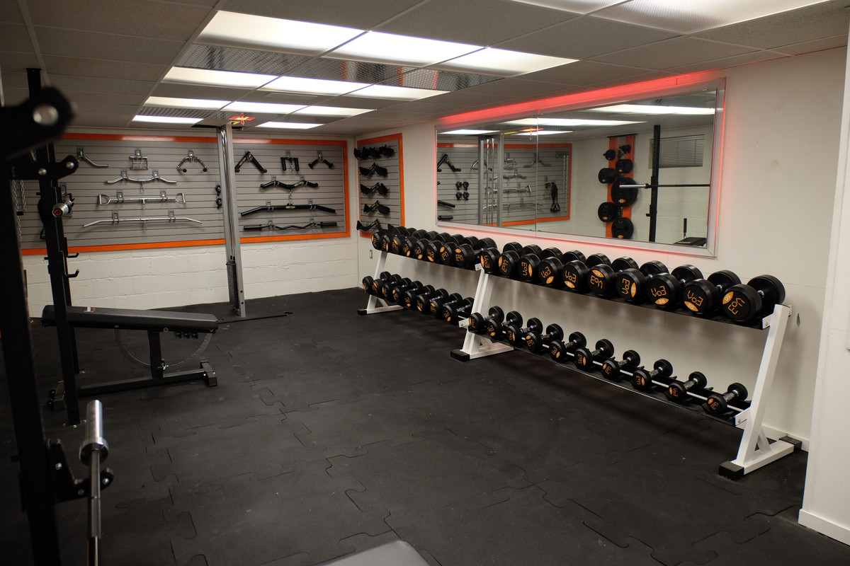

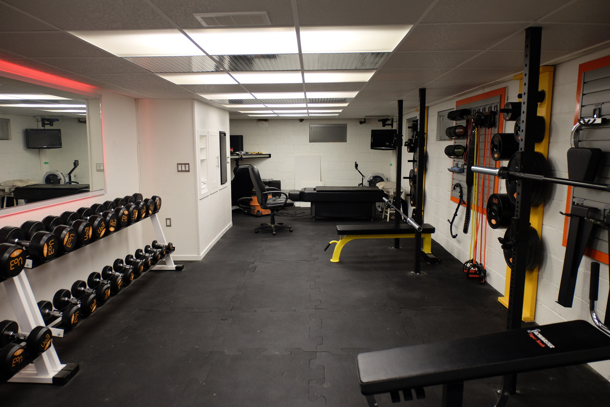

I just looked at the second photo you posted. That is indeed difficult. I have lived in problematic rooms before. In that situation, I would just stash conventional speakers under the tv in a semi-portable arrangement. Then either leave them under there to do whatever they will at low volumes, and bring them further out when trying to eek out something a little better from it.
If I pulled the oled further ahead I could I theory build my own speakers beside the oled panel , as it would give me the opportunity to build speaker boxes that are triangular in shape , maybe getting me enough volume for some decent 6.5 mids and some tweets .

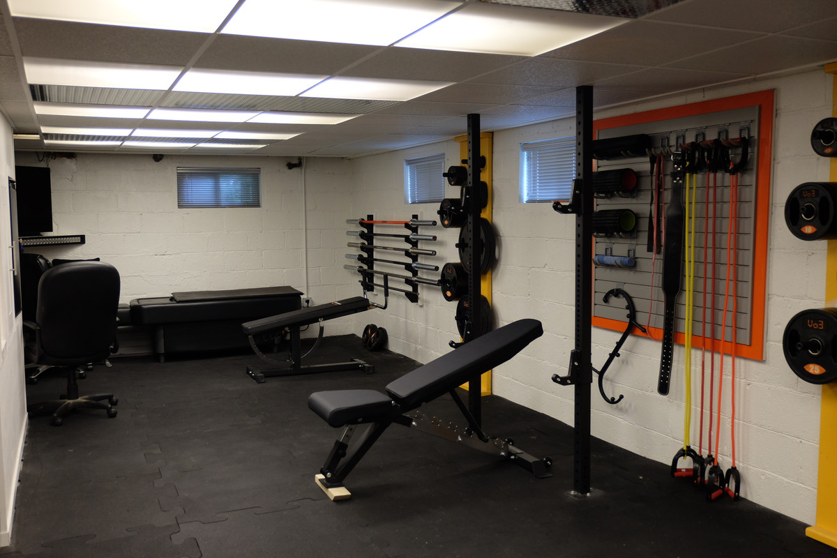

Yes, that certainly is a possible approach. You say that is a gym. What sort of size of space are we dealing with here? Is this a home gym or commercial space? If this is a commercial space, then robust engineering needs to tbe the order of the day.
No just a home gym in my basement . The lg panel and speakers are in the far corner 0f the gym , but years ago I purchased paradigm studio in wall speakers that were going to be installed on each side of the mirror . That way I should get enough volume through out the space . The gyms the length of the house and just over half the width at about 13’ . Not sure how long the house is though , it’s old and only 870 sq ft .

That is a huge not very promising space. That corner location is a problem. You are going to need some speakers with some serious spl. to fill that space. I am not surprised your current system is totally inadequate.

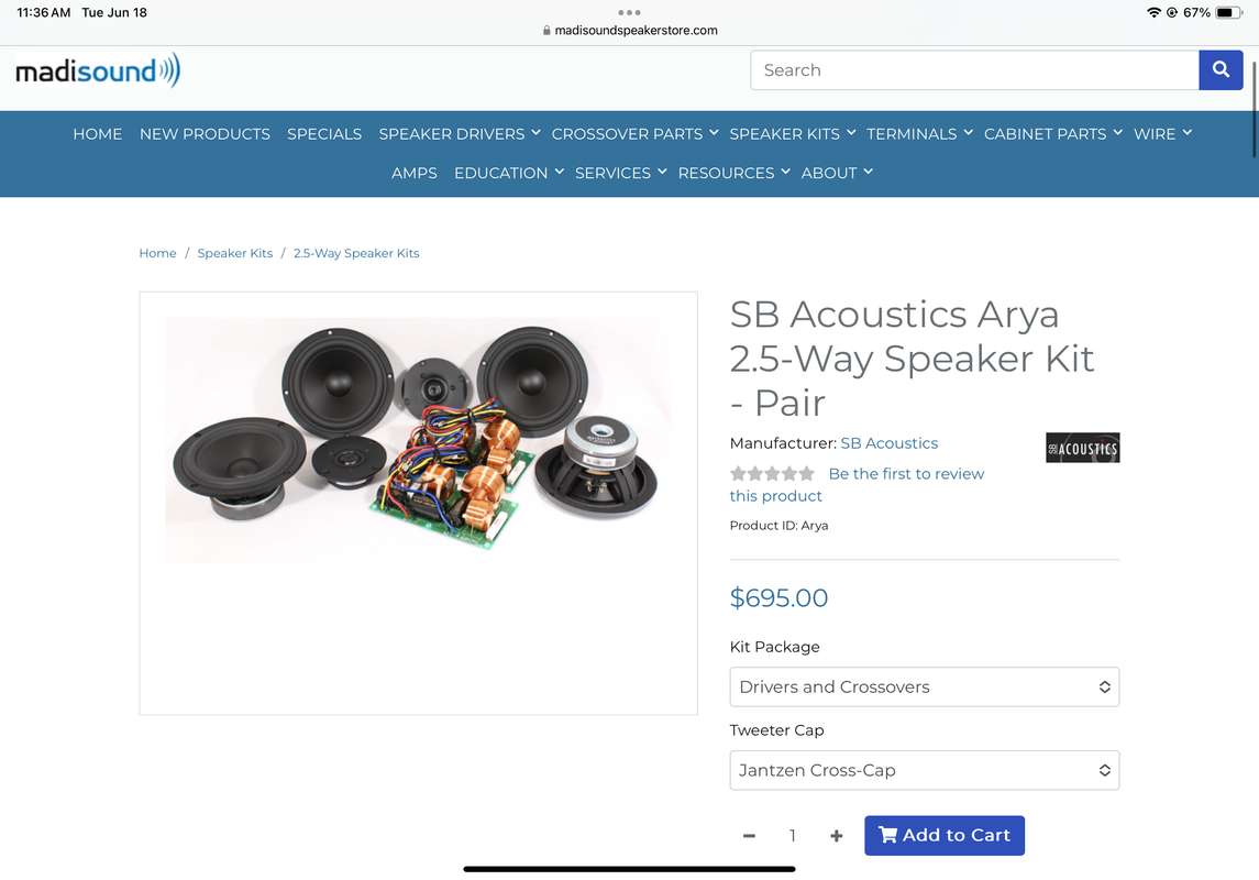

Thank you , there’s no rush on the speakers . I’m kind of liking this kit here . Dual 6“ midbass drivers and a tweeter. Now I’m thinking a 3 way system may be over complicated, and a 2.5 speaker setup may be the better way to go . Good call .
I’m open to other kits , as I just seen this and it looked like a viable option depending on how much volume I need in the enclosure
