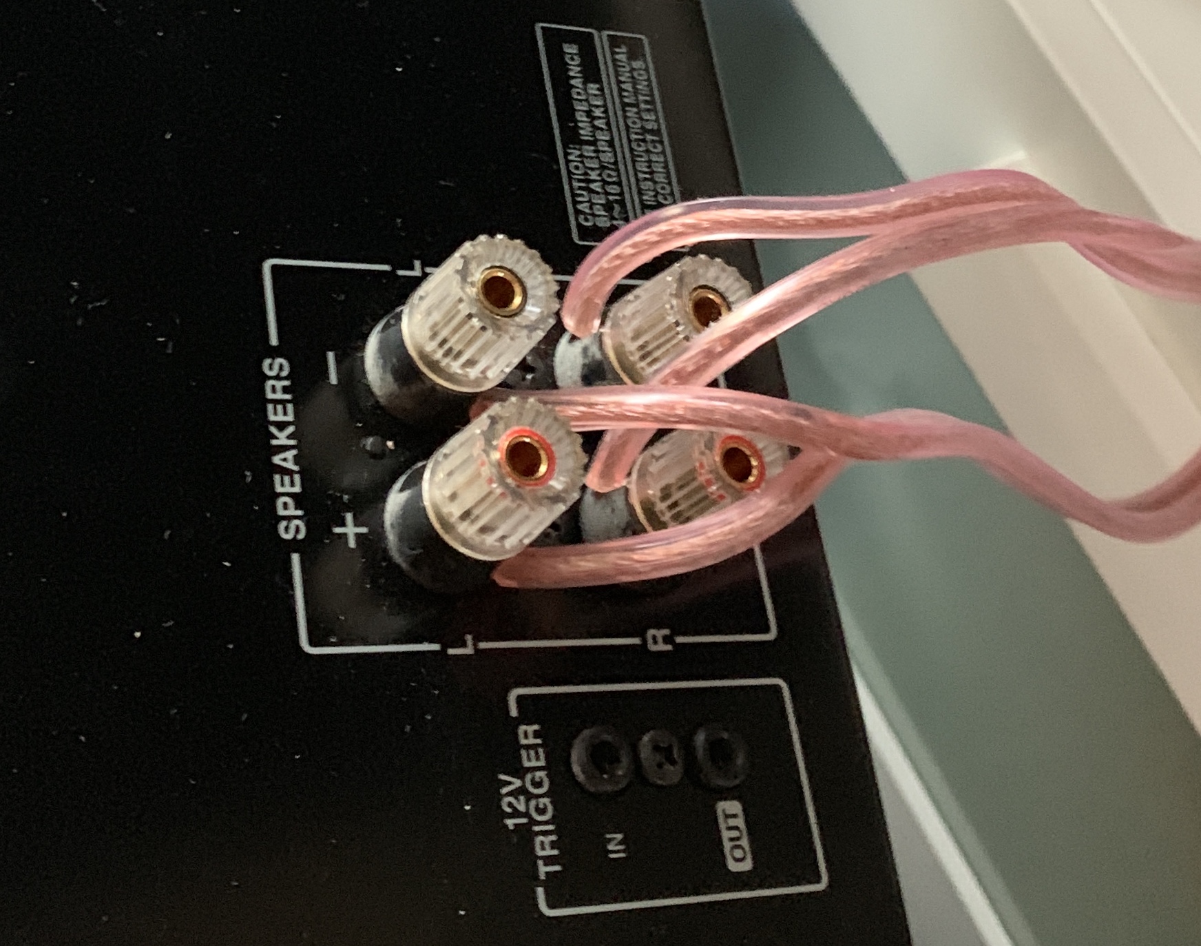

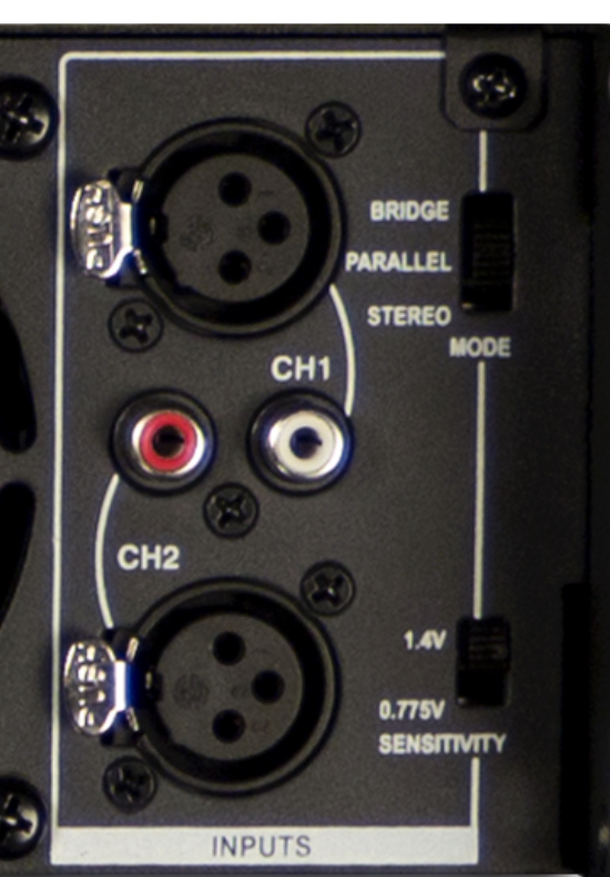

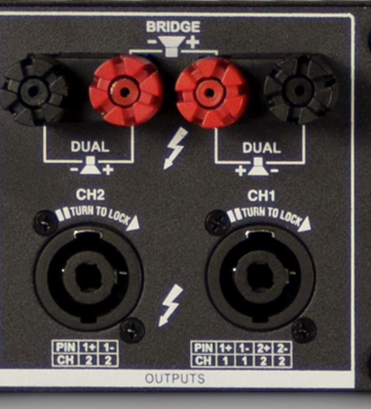

This is the old dead amp. Simply take these 4 wires and correctly pair them on the xli800? Then use the RCA input for my apple base station for airplay.
N
NewGuy2.0
Perfect thanks. I’ll give it a try. The mode should be on stereo correct?
