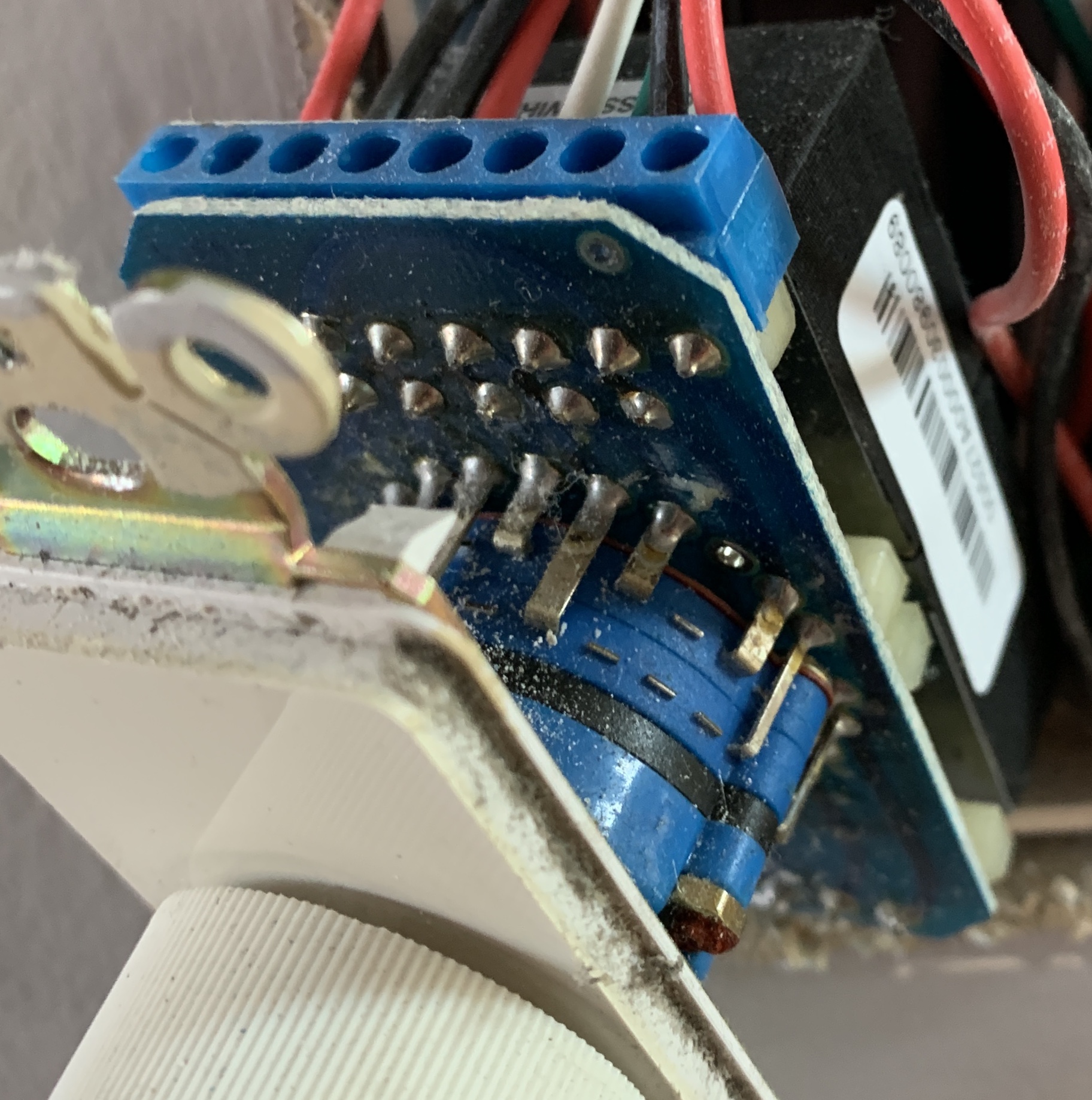

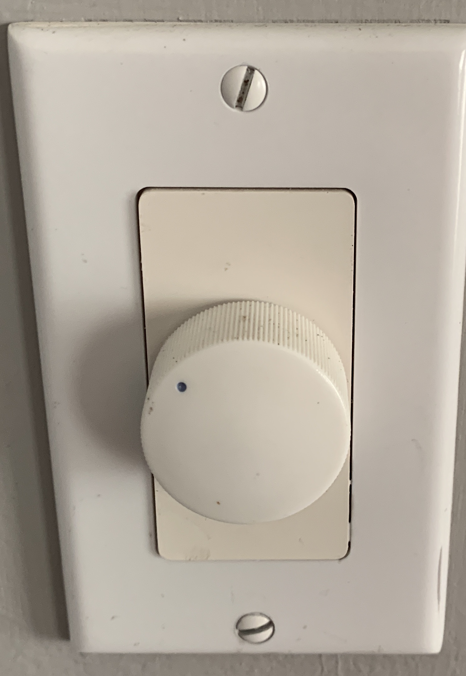

This is the wall switch. What are your recommendations now? Do I buy the same Amp as before or is there a better solution to work with this setup?View attachment 28543

Removing the dust and debris in the junction box and on the controls wouldn't be a bad idea and then, show the rest of the control.
If that has the autoformers (they look a bit like small transformers),you should see a pair of small jumpers, made of plastic. They're for connecting more than one pair of speakers and more than one control but if you have a control for each speaker output on the SSS-6, make sure they're appropriate for their location, as in, make sure the one for the outdoor speakers is made for outdoor use, if it's not on an interior wall.

The brand of control doesn't matter- the SS-6 is just a group of switches on a circuit board in a box, with a resistor in series for each channel to make the amplifier happy.

That does look as if it is most likely an impedance matching control. Is there a manufacturer and model number on the control?

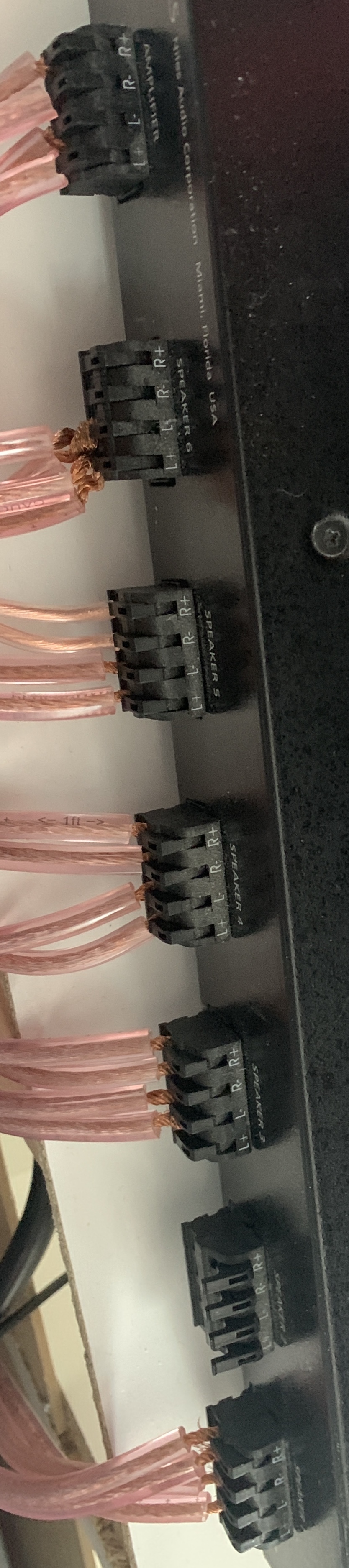

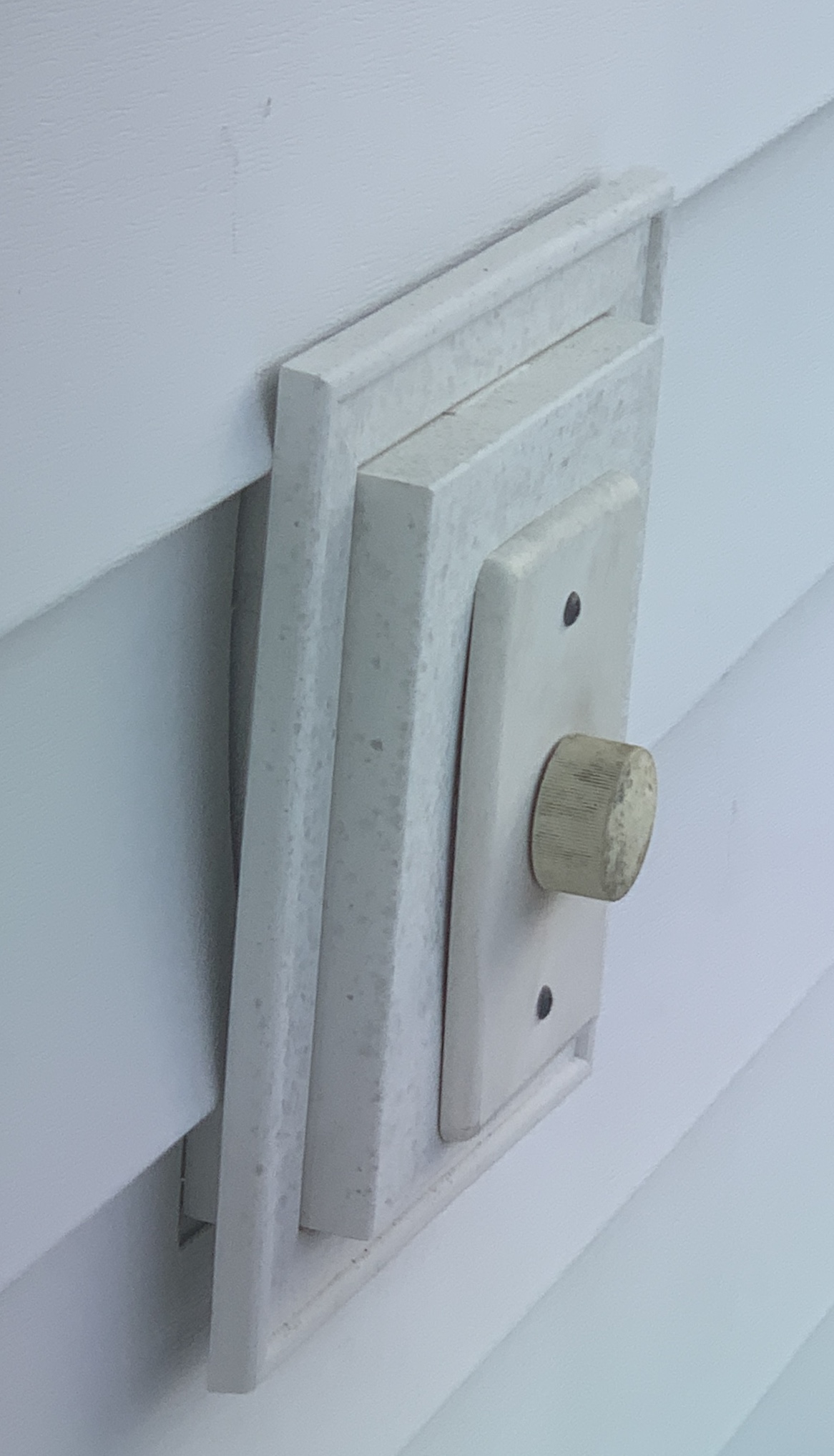

The Niles is hooked up in the back like this in the pic. Each set of speakers are connected properly. The single speaker for the bathroom is connected differently like in the pic. Also the volume control for the outside is posted below too. Do I buy the same amp and try again with protection off?

The Niles is hooked up in the back like this in the pic. Each set of speakers are connected properly. The single speaker for the bathroom is connected differently like in the pic. Also the volume control for the outside is posted below too. Do I buy the same amp and try again with protection off?View attachment 28548
You need to look at the speaker wires- it looks like some strands from + and - are touching and that WILL cause the amp to shut down. Also, the wires that are doubled on the connector- why? Don't do that. If it's a dual voice coil speaker, connect one set of terminals to Left and the other to the Right channel. The way you have it, you'll never hear the right channel, at all.

I believe the protection was always ON the Niles. Weird that when I connected my express base station for airplay, I checked each room for sound and there was no issue. It played music fine on several occasions. What would compel the amp to kick it is beyond me. I had all locations turned on with high volume and it stopped.
The Niles is hooked up in the back like this in the pic. Each set of speakers are connected properly. The single speaker for the bathroom is connected differently like in the pic. Also the volume control for the outside is posted below too. Do I buy the same amp and try again with protection off?View attachment 28548View attachment 28549
Those shorting connections show the reason the amp blew up and has been destroyed. That is a horrible mess.

I will fix the + and - so they don’t touch. The double wire connection was like that when i moved in. There is a single speaker in the bathroom and the wall plug has a double + and - connection which I presume they doubled onto the niles switch. Can i remove one set of wires from the + and -?
