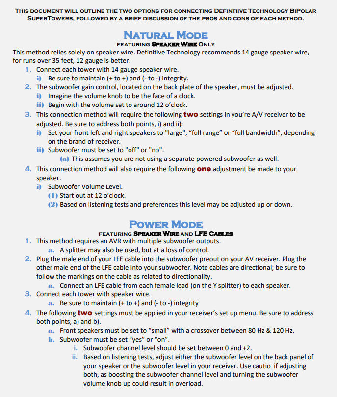

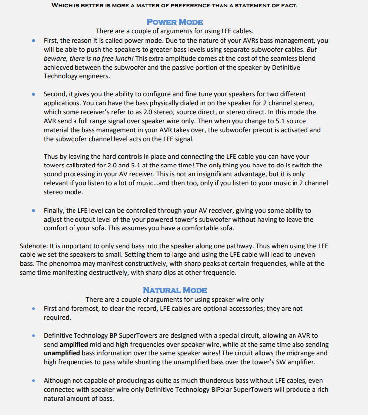

Gotcha. So I called DefTech and here's what they advised. Set speakers to SMALL and crossover to 80hz (can go up to 100hz). Then set the subwoofer crossover to 80hz (can go down to 50hz). This is using LFE connection in my subwoofer. Also, the subwoofer has low pass filter knob at the back, she said just leave it at full because the receiver is the one handling it instead. That knob will be bypassed. She sent me an email also for some instructions for my speakers setup. I will attach it here. Hopefully you guys can chime in as to what it says in the 2 ways to set it up.
Gotcha. So I called DefTech and here's what they advised. Set speakers to SMALL and crossover to 80hz (can go up to 100hz). Then set the subwoofer crossover to 80hz (can go down to 50hz). This is using LFE connection in my subwoofer. Also, the subwoofer has crossover knob at the back, she said just leave it at full because the receiver is the one handling the crossover instead. That knob will be bypassed. She sent me an email also for some instructions for my speakers setup. I will attach it here. Hopefully you guys can chime in as to what it says in the 2 ways to set it up.
Speakers/sub have a single "crossover" in the avr. What sub crossover? Many subs do have an LFE setting for input that bypasses the sub's own low pass filter (very few subs have a crossover at all).
