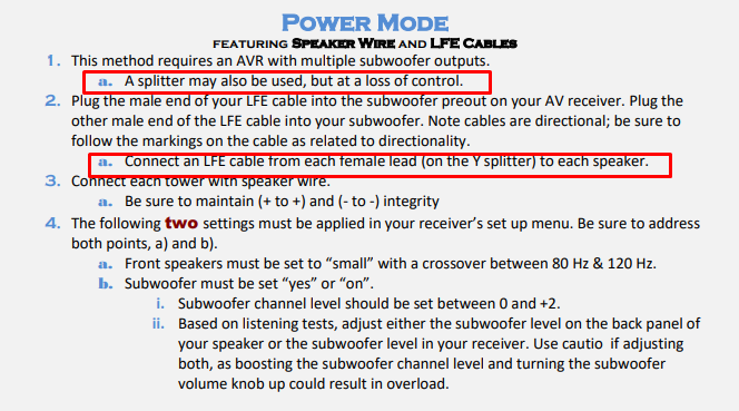

Guys, can you help me understand this? It mentions about using a Y splitter. I don't understand what this means. Right now, I only use 1 RCA cable from the AVR's Subwoofer OUTPUT to my DN10 subwoofer's LFE input. The front speakers have LFE input but I'm not using that, I use speaker cables from AVR to Front speakers. What is "loss of control" means in this manual? Thoughts? thank you!

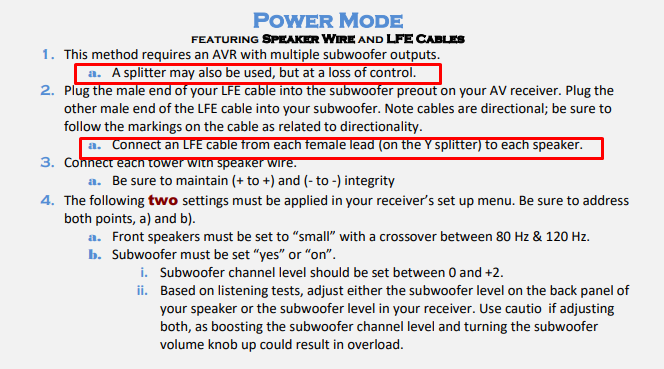

Guys, can you help me understand this? It mentions about using a Y splitter. I don't understand what this means. Right now, I only use 1 RCA cable from the AVR's Subwoofer OUTPUT to my DN10 subwoofer's LFE input. The front speakers have LFE input but I'm not using that, I use speaker cables from AVR to Front speakers. What is "loss of control" means in this manual? Thoughts? thank you!View attachment 60465
You're fine as is for what you're doing. What manual is this from, the speakers with powered woofers I assume? If the avr actually had separately independent sub pre-outs (the most common up til now is 2 indpendent sub pre-outs, such as used by Denon & Marantz in their Audyssey XT32/SubEQ equipped avrs, altho their most recent models can do up to four subs in such a manner....this is still just level and delay per sub, they're generally eq'd together), then if you put a splitter on one of them I suppose that could be construed as loss of control. Most avrs, though, even with two sub pre-outs are just an internal y-splitter, both pre-outs are identical. If using speakers with powered woofers as long as they were equidistant to your listening position it really wouldn't be a problem otoh. A splitter like this I assume is what they're talking about so you could use a regular male to male sub cable to each speaker.
Hello there again my friend. Yes, this is the manual for the Def Tech speakers. So if I understand you correctly, I don't need to mess with the LFE connections of my front speakers even though they have an input available. AVR to front speakers using speaker cables, AVR to SUB's LFE input using RCA cable. I'm ok in this wiring? thank you!!!
Depends if you want to use the powered woofers via the sub pre-outs. Thought you were going with DefTec's advise and not doing that, using your sub instead and just using speakers (connected with speaker wire) set to small/use bass management.
