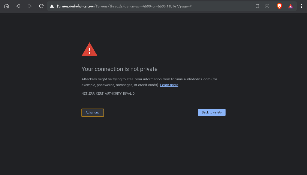

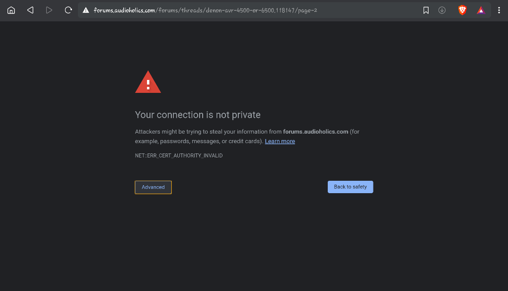

Interesting. I got that today too, but I was on Rain Birds website, and following an internal link. Weird. I’ve only seen that message a few times in all my browsing.
I did a soft reset on my router and tablet, cleared caches, etc.. Seems to have cleared it up. Before that I couldn't post anything with either Brave or Chrome. It was only here too, weird.
