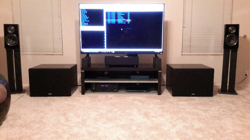

This pic is from when I first started upgrading my 20 year old system. I've since replaced pretty much the whole front stage and tv and have it mounted in the wall now. If you look under the tv you can see its sitting on top of 2 pieces of lumber (10cm x 15 cm) that I stained black, and it not only worked well, but I think it looked nice too. All you need is something to lift it up a few inches higher so you can slip your center channel under it.
I made those speaker stands too. I had the leftover scraps so cut a couple pieces long enough for the tv's feet and stained them black. Cheap, easy and non-invasive!
Man, it seems like a lifetime ago since my front stage looked like that. It has totally evolved and gotten much better looking. It was so bare up there!
Looks awesome buddy! I like it :D
