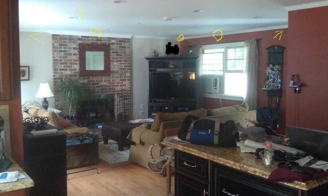

Thanks for the Info! Could I post some pictures of the room so you could really see what I have going on? I think I would benefit a lot from that if you dont mind. These pictures would have to wait until Monday whem I get back home though

Well that's my current setup. In yellow I have the hookups, and in red I drew possible speaker placement for the front three speakers? Now that you said not to use the ceiling hookups for the front three, ill abandon those and just hook them up to the receiver.
One question, can you move that Air Condition to the window
next to it?

ABdrummer
I suppose so. It might be a little awkward but if it's necessary, sure
Compromise seems to be the name of the game with certain
set-ups. It is no fun listening to music or watching movies in
the heat - however, I would still prefer the left and right fronts
down near the center. It is up to you about the A.C. - however,
moving it can help a little with speaker placement.
I would match-up the A-25 bookshelf with the A-250 center. Did
you check pricing at Onecall or AC4L - white with black grill is >
$79 each.
