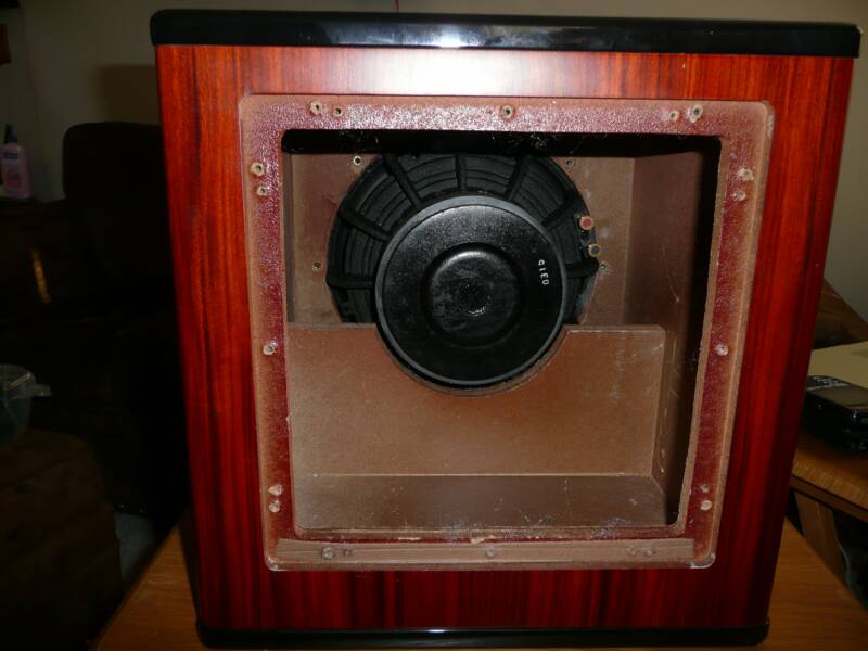

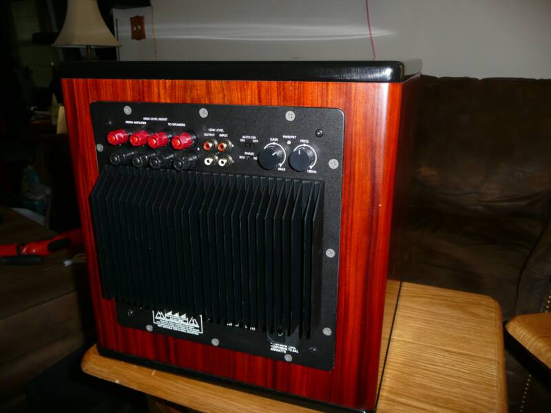

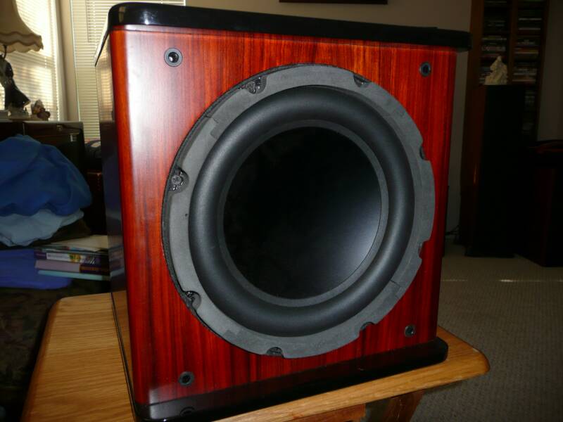

Here is the sub, I had to use drywall screws because the gasket was so thick, so I used gasket material to help seal it. It turned out tight and solid. I'm working on testing tonight, I'll post back when I have it in place an dialed in.
Here it is with the Dayton SA240-B installed.
I have to test it out but the wife has had a near week long migrane so I hear it but can't push it. So far it sounds excellent and very tight. :)

so wait, did you just end up using a dayton amp plate as a repacement?

Hello KlipschHead281.
The sub looks impressive.
What are the specs?!
Regards.
It's an AV123 UFW-10 subwoofer with Dayton SA240-B plate amplifier. A disappointment after last nights testing. The subwoofer is fine, it's the amp I shouldn't have bought. I'll be posting about it in a few min's.
Yeah, it measured almost exactly as the opening so I took the easy way and it bit me in the rear. This amp just doesn't have the power for this sealed sub. I'll post what I posted at AV Science Forum.
