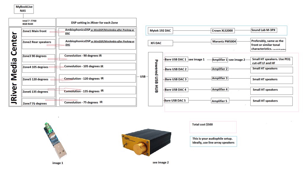

Just an update.
I have now successfully added four additional speakers for convolution with JRiver.
The following diagram is how got the 8 speakers running.
Well, I would say you easily met the goal of convolution! :confused:
:confused::confused:

Thank you. The timing difference is 40ms and adjustable in the zone. Usually, the will be slight delay for few seconds before JRiver stops and plays again. That only happens when you start the first track and thereafter no issues.
I am still experimenting whether the timing drifts after sometime.

This is a follow up. To those with 2 channel HiFi setup can use JRiver multi zones for Convolution channels. IMO, this is the easiest way to improve the SQ of your system.

Agreed, take a look at the picture for both setups, a crap load of amps, speakers and to get surrounded by sound. I've been to concerts and sadly an Opera and the sound does not surround you yet the claim is this kind of setup most closely resembles live. The example above in my view does not mimic live even a little.
