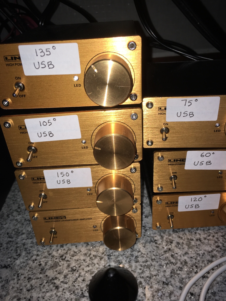

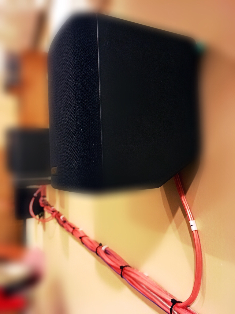

The convoluted surround is not only for Ambiophonics but can also be used with your current stereo setup.
Basically, you are transforming your room to another venue. I am using St.Cecelia IRs each of them are about 2.1s.
You don't need 20 speakers. Ideally, I should add 8 more speakers but my room is small so I have stopped for now.
The most important convoluted sound is the 90 degree reflection from the side. Even with two, you would experience better ambience with your current setup.
OTOH, Ambiophonics is only confined to the main speakers.
And yes there are 20 speakers in the room. Except for my main speakers - Sound Lab electrostatic the rest are cheap HT speakers.
And the amplifiers to drive these speakers are small digital amps that you can buy for $40.
And the DACs only cost about $9 each. These are for the surround speakers. I use Mytek and CrownXLS2000 for my main speaker.
