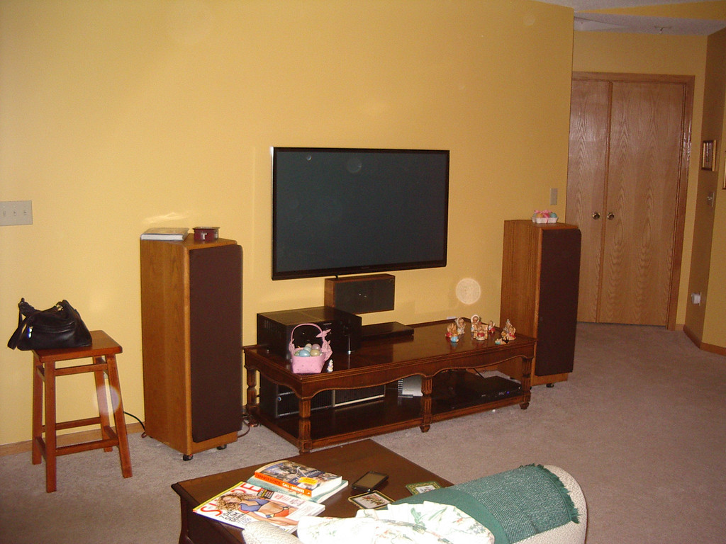

Interesting concept!
This point I’m about to add is not based in science so bare with me here plz!
Based on what I perceive your trying to achieve it is my opinion that there is to much emphasis placed on the centre channel to begin with!
That emphasis is to make the centre channel a discrete channel while in reality it should support the main speakers not take over their roll in stereo or HT!
Assuming a centre channel may receive up to 80% of the responsibility for voicing dialogue in HT content and to a very large extent the vocals in 5.1 music videos, I would say the recording studio needs to reduced the emphasis placed on the centre’s channels roll by placing the bulk of the dialogue back in the main speakers mix like when a phantom centre is channel is used.
From there the centre channel only re-enforces the phantom centre similar as when bass management is used so a sub anchors the low end for the entire 5+ other channels.
That way more impact is given to the dialogue without it appearing to originate from the centre channel. A phantom centre seems to come from where we want it which is the actors or singers mouth. With a centre channel playing to large of a roll it appears disconnected from the screen which actually attracts attention to itself rather than the image on screen!
