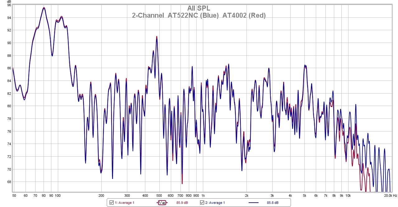

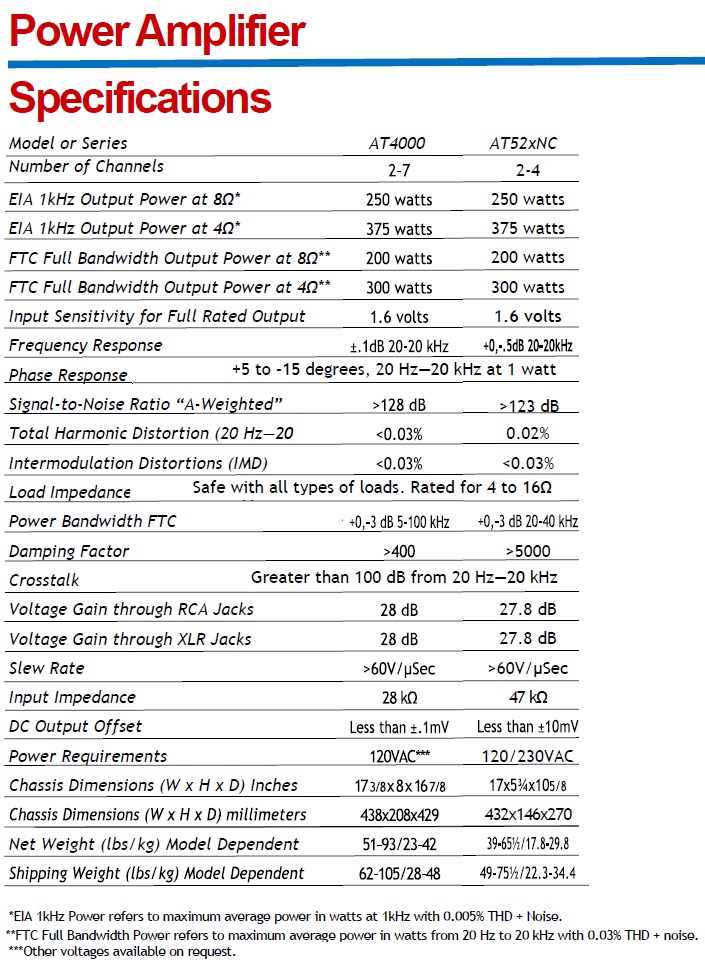

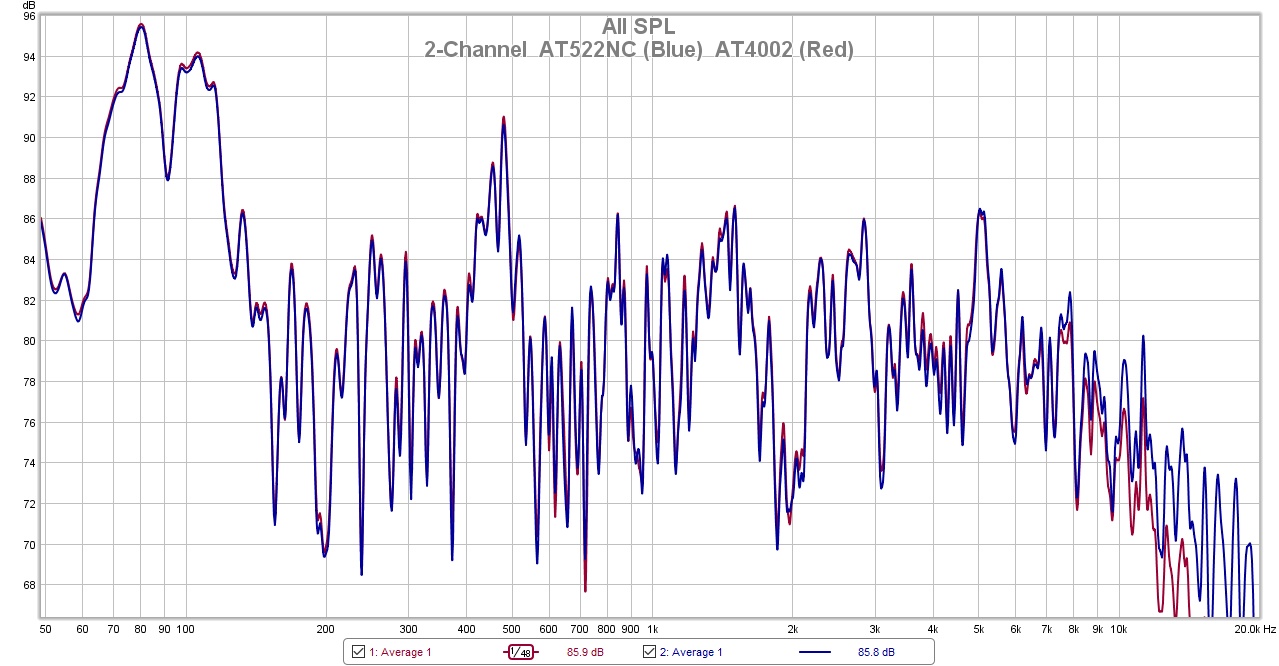

Here are the specs and measurements of the AT4002 (Class A/B) and AT522BC (Class D) with identical power specs.
The measurement was taken using the UMIK-1 calibrated MIC using REW and smoothed to 1/48'th for readability.
The system is an Oppo Sonica DAC with Balanced outs split to both amp. The Microphone is centered about 10' from the wall mounted Revel M20 bookshelf speakers. Three sweeps for each amp and swapping the speaker cables between amplifiers.
These amps don't measure the same nor do they sound the same.

Seems more a speaker/room measurement than an amp measurement but then you don't explain details....
It could be due to some slightly movement of the mic between the plots, you can see there are some difference above 9k Hz, below that I highly the minor differences would be discernible even by Rich's better hearing.. I didn't get that kind of difference at all when comparing the FR graphs between my class AB amps and AVRs, also using REW and Umik-1 mic. Too bad I still don't have a class D amp to compare.

But which one sounds better to you, and just audibly different, or night and day kind of difference?
RichB
RichB
It depends on the source material. The best characterization for the AT522NC is that it is more lively.
Which depending on the source is sometimes better and sometimes sounds less natural to me.
However, that may only be because I am used to Class A/B amps.
I can say this for certain, these amps are different, more than other class A/B's I have had in my system.
I have yet to try them with my Salon2's.
- Rich
