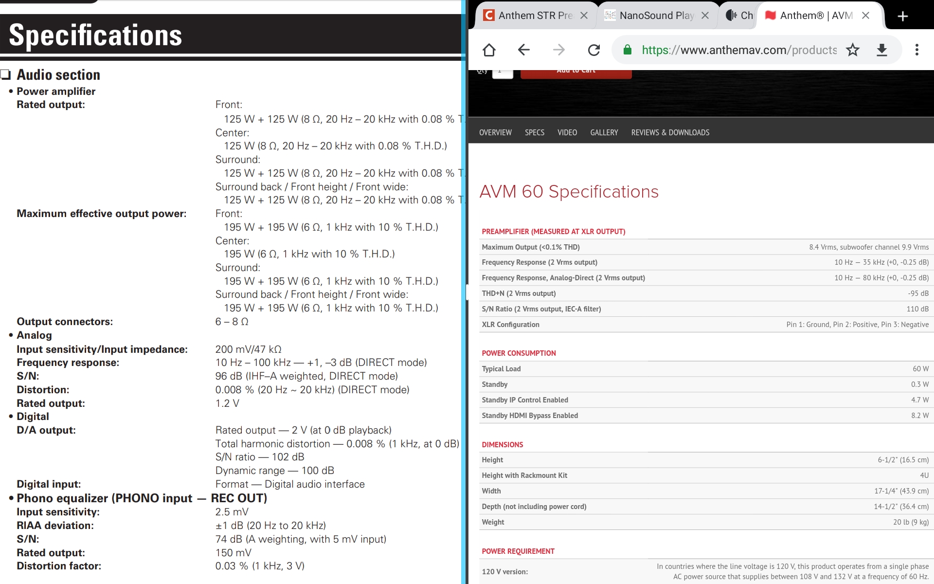

One thing I have taken note of is my AVR preouts are rated at 1.2 V and the Monolith needs 1.5v for rated output, so I don't think I'm taking full advantage if I actually wanted to play louder. I will upgrade at some point to a pre/pro for Atmos/DTS X and looking at Anthem AVM 60, which is rated at 2V and has better measurements than the Marantz SR7005 I am currently using in terms of THD and SNR.

3. my Marantz SR7005 preouts are rated at 1.2 V and the Monolith needs 1.5v for rated output, so I don't think I'm taking full advantage if I actually wanted to play louder.
4. I will upgrade at some point to a pre/pro for Atmos/DTS X and looking at Anthem AVM 60, which is rated at 2V and has better measurements than the Marantz SR7005 I am currently using in terms of THD and SNR.

3. @PENG can verify, but surely the Marantz 7005 pre-out voltage is higher than 1.2V.
4. What is the difference in THD and SNR between the Marantz and Anthem?
Be careful comparing manufacturer spec sheets. The output voltage you're quoting from Marantz is NOT a max rating. Their receivers can do 4Vrms unclipped so you can bet their preamps can as well. The AVM60 is NOT an upgrade in terms of analog preamp compared to the Marantz.

Sr7005 and AVM specs:

According to S&V, the Marantz SR7005 has a SNR of 98dBA, the Anthem AVM60 has a SNR of 127.91dBA, the Marantz AV8802 has a SNR of 130.38dBA, and the Yamaha CX-A5100 has a SNR of 130.92dBA. So these pre-pros academically have much better SNR than the Marantz SR7005. :D

As Gene said, "Be careful comparing manufacturer spec sheets" on pre out specs
A couple of points to consider:
  1. XLR output is often higher, e.g. 2X, but may not make any difference in terms of the overall gain. For example, Bryston, Marantz and many other power amps would want you to flip a selector switch such that if you select balanced, the sensitivity would be halved. You can download a Bryston manual (such as one for the 3B/4B SST) and you will know what I am talking about.
  2. The specified output is often not the maximum, and based on past bench measurements they could hit over 4 V unbalanced without clipping, that would be over 8 V balanced, comparable to what Anthem specified for the AVM60
The AVM has much better noise specs than your AVR though the effects will likely be not audible. The newer Marantz AVR such as the SR7012/13 or even the SR6013/14 do have the same DAC chip as the AVM, and probably better preamp/vol control chip, now that they have been upgraded to individual chips instead of Anthem's LSI (large scale integrated). Those things are again, while differing in specs, but for practical music/movies it will be difficult to tell if one is better than the other unless you can't see which one is playing. Between the AVM60 and a comparable Marantz AV7705, I would just choose based on the feature set and price.
