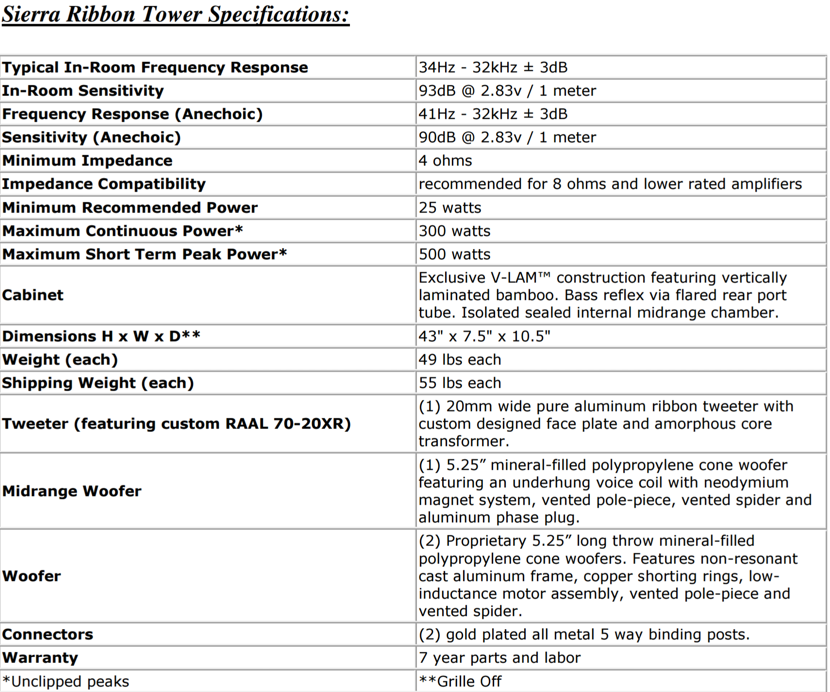

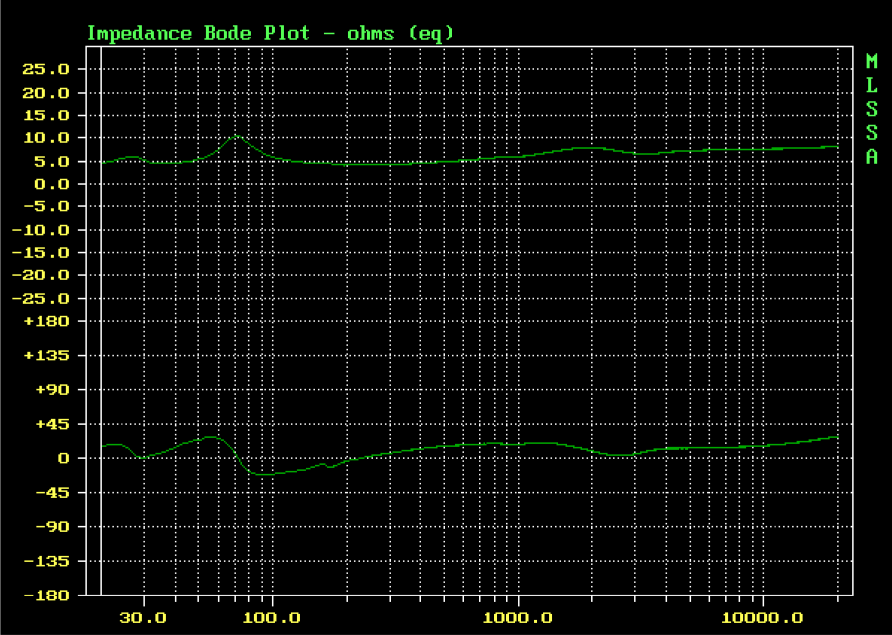

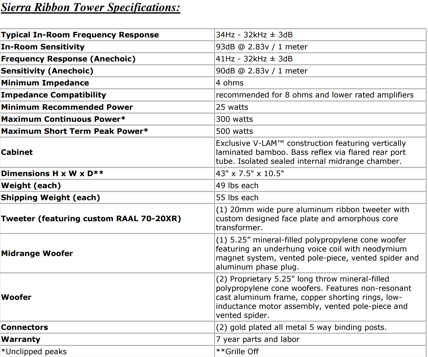

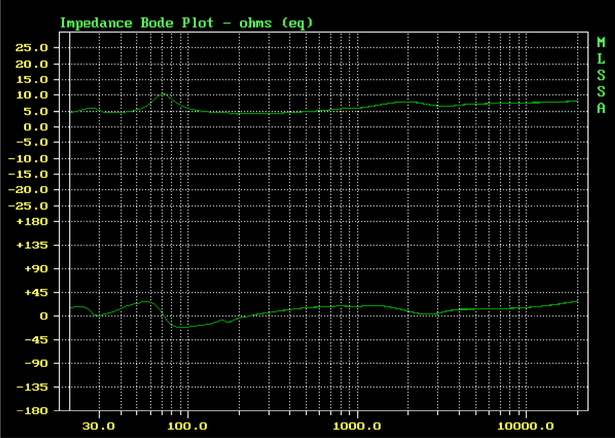

87 db @ 2.83v for the Ultras (published 8 ohm, but gene found them to be 6 ohm speakers I think, if not 4 ohm...)
90 dB @ 2.83v for the Sierras (4 ohm)

Peng, I think you missed that I bought a pair of Ascend Acoustics Sierra ribbon towers and received them last week. They're the ones I'm concerned about over driving. They're 4 ohm speakers and well, here are the specs.
*Edit: They're rated for more than I realized! For some reason I was thinking it was 150w max continuous power.
That page is for the dome tweeter version of the Sierra. Here's a link to a pdf for measurements and specs for the ribbons.
Okay then, the Ascends in your system will still be the bottleneck as it is only rated 500 W maximum short term peak. You will need about 660 W to hit reference level with one speaker from 15 feet.
The Monolith can output only a little more than 500 W average short term dynamic peak, that's 1,000 W peak, two channel driven into 4 ohms.
