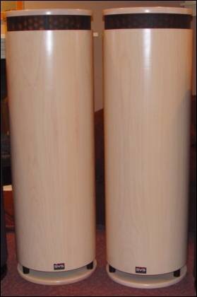

Iirc the ultra cylinders were 46” tall. Not too bad in my estimation. How bout these...
You can get tubes with a diameter much larger than the driver too. I remember DIY projects from back then who did this, you can get very nice 2-3ft high rounded end tables/coffee tables.

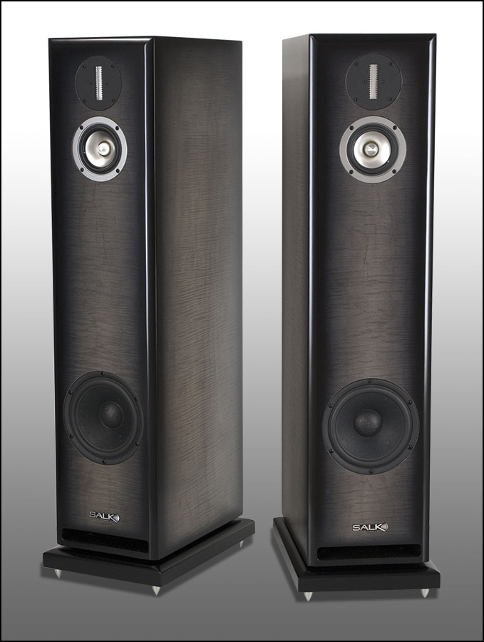

@Defcon, absolutely, but if you had the option, and budget to get your favorite boxes refinished in a way that could match your personal aesthetic AND budget, would you choose the PC4000 as is available today? Or a PC 4000 with your choice of beautiful wood veneer? Likewise, would you ask Salk to build you satin black, or one of the other standard finishes that are stunning?
http://www.salksound.com/gallery/Song3/s3-grayburst.jpg

Good question and its hard for me to answer. Honestly if I truly were that rich, I can think of plenty of other luxury items I want to spend my money on. And actually, in a real HT the speakers are all hidden anyway, so no, I wouldn't care for the finishes. For a living room setup, sure if money were no object I'd still want to get the highest performance (which would not be the costliest hifi speakers for sure) and then have a nice finish. Glossy shiny piano black with red cherry accents all around :)

It kind of is all about looks. I believe the point of diminishing returns is far earlier than most people think and there's no way the $100-300k speakers are 100x or even 10x better than a $1k speaker. Many of the ultra high end components also measure horribly and fare poorly in any blind test. There's a reason almost no company in home audio and esp high end will ever list measurements or even specs and their entire marketing/sales is based on selling to people based on their name/status and salesmen pushing the product.
Theres nothing wrong with premium finishes, these are furniture as much as speakers, as long as people understand it does nothing for the sound. I don't want to pay for any of that. Many of the high $$$ speakers contain cheap drivers and gorgeous finishes.
Lol. Ok when you said high end, I was thinking of companies like revel, or legacy for which performance, and appearance are equally important. I guess I figure speakers that cost 100k need a qualifier since they’re pretty rare, and in this forum especially, they don’t come up very often. I do agree that diminishing returns happens far sooner than people realize. Keep in mind though, there’s a lot of gray area between 100k speakers and where most of us shop, and even still at 10k, you can still get speakers that have a high value level.
Yes indeed, sonotube comes in many sizes. My thoughts of endtable/coffee table subs aren’t very high since imo, placement in those locations would be at a disadvantage. IME subs don’t work as well in the room vs corners or against walls. People usually do this for waf.

If someone was selling a 15-18" sonotube sub or even a DIY kit, I'd buy it. You can easily place them in corners, thats where I have my SVS cylinder right now.
Danzilla31
Talking to one of the SVS cats the other day, he mentioned their pres shooting down any possibilty of turning their ultra line into a PC version... it would just be too huge! (I'm envisioning an 18-20"dx66"h tube!). But if you could get that in candy apple red, blackberry pearl, or just piano black... Damn! That would be a statement to have four of those anchoring your room! @Danzilla31, C'mon, I know you'd be there! :cool:
Regardless, I like downfiring, and I really want the PC's from SVS. I wish I could still consider a cylinder from Hsu. But the output from the pc's are a little lower than their pb brethren.
I'm with you brotha let's go! Road trip and maybe if we show up at there front door we could talk them into an ultra PC! And hit up that Double Impact while we're at it! Lol

I’m also surprised that SVS doesn’t make a sealed pc. It would probably be so short it wouldn’t have any aesthetic advantage lol!

The ID craze was started by Svs (and Hsu) using subs made out of sonotubes - certainly not wood. And there was absolutely nothing wrong with them.
It was more started by Hsu, in 1991. SVS came a bit later, in 1999 I believe. They both started out by using sonotubes.

As an engineer, cylinders are definitely the way to go! They always should offer better performance for less money (or at least should if companies are being "honest" with their pricing)!
Obviously SVS knows exactly which shape of subs sells better since they can directly compare essentially identical PC (ported cylinder) and PB (ported box) subs.
I'm not sure about which is more imposing or looks more powerful, but it doesn't matter, in the end it is an issue of "beauty is in the eyes of the beholder".
It is curious that I have never seen a sealed cylindrical sub!
Hsu stopped selling cylinders because the demand for box subs was vastly more than the cylinders. I imagine that the demand for box subs is much more at SVS too. I wouldn't be surprised if the box subs outsold the cylinder subs at a 10 to 1 ratio.

Hey Shady does Hsu still do sonotubes? just curious
I wish they did. I have bugged Dr. Hsu about using his 15" in a cylinder, but I doubt it will happen. Turns out Dr. Hsu would rather manufacture subs that sell than design and manufacture a money loser for my own personal whims! Greedy! However, I suppose if I really wanted the 15" in a cylinder, I could make it myself pretty easily.
