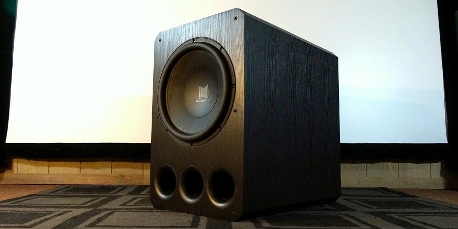

At last, it is here: our review of Monoprice's monster subwoofer, the Monolith 15" THX Ultra! This 130 lbs. beast might look like it's all muscle, but there is at least as much brains as there is brawn in this design. As we found out during our evaluation, there is a lot more to this sub than mere loudness, and to see what we discovered, read our in-depth review: Monoprice Monolith 15" THX Ultra Review. Monoprice managed to create a buzz about their subwoofers, and we at Audioholics were regularly asked when we were going to review these subs. Earlier this summer we dealt with the 10” and 12” subwoofers in the aforementioned review, but now it’s time to turn our attention to the heavy-hitter, the Monolith 15” THX Ultra.
After many requests from our readers, and quite few delays, we have at long last brought you our review of Monoprice’s flagship subwoofer, the Monolith 15” THX Ultra. As was promised at the end of our Monolith 10” and 12” THX subwoofers review, we finally got a chance to review Monoprice’s full Monolith THX subwoofer line. The 10” and 12” impressed us with their no-nonsense, heavy-duty designs, and we expect the same but even more so from the 15”. The Monolith subwoofers entered the market sporting THX certification and and very respectable set of performance measurements that made people take notice of their seriousness of being a very real competitor in this fierce market. Can the Monolith 15” THX Ultra deliver on the promises made by its smaller brothers? Let’s find out...

Thanks for your review, I have owned dual Monolith 15's in my dedicated 250sq ft (1999 cubic sq ft) theater room for about 5 months now and I love these subwoofers. Previous subs include quad sealed DIY 15", Hsu VTF-15H, and several different SVS and eD variants. I have never owned a subwoofer with this type of sound output and your review is spot on. You won't get boomy bass with this subwoofer. I have yet to experience any noticeable port chuffing, You get very tight, linear bass at all frequencies. I have grown very fond indeed of the sound signature of these subs and highly recommend them.
And you can't just look at some charts and measurements either, you really need to experience one of these vs say an SVS, PSA, or Hsu sub. I think Monolith has a winner for sure and I am hoping to get several more of these over the next year or so.
ShadyJ, if you have contact with Monolith please beg them for an 18" version or perhaps dual 15" ported version :)
Anyone else turned off by the logo on the driver? That's what I'd ask Monoprice to do, have that as an option at least if not just gone.

I have asked Monoprice if they are considering an 18", and they said that they are not. An 18" with this kind of build would be too heavy. However, if there was enough demand for such a sub, I am sure they would reconsider...
A little like having the white lettering of your tires facing out instead of in. :) Very 80s style but it’s behind the grill.

How does it compare to Rythmik FV15HP and PSA V1510 comparing price, aesthetics and performance?
I think you will find that these subs compare very closely to each other across all those areas. If you can find a better deal on one vs the other you should buy it.

In terms of deep bass, they are similar, but in mid bass frequencies the Rythmik has a couple dB of headroom, however, the Monolith 15" has so little distortion in mid bass that I would say they are a tie in dynamic range. Pricing is nearly the same. Aesthetics is a more subjective area, but a gloss black Rythmik would be my choice in that area, although there is a $300 upcharge for that. I doubt the PSA sub is in the league of the Rythmik or Monoprice subs, especially in terms of deep bass performance.
