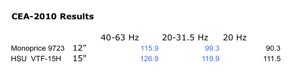

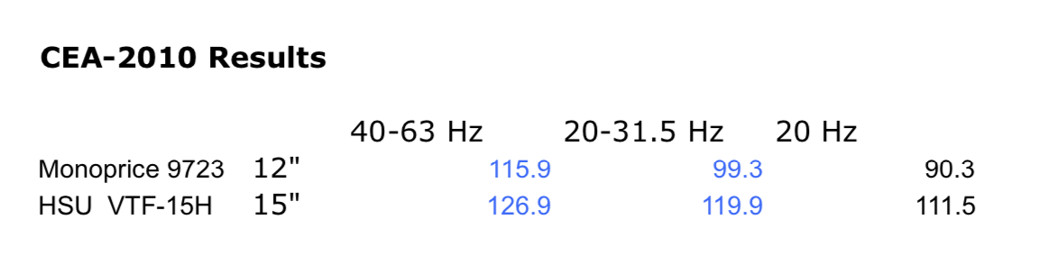

Here's some of the CEA-2010 data comparing HSU 15" to 12" mono.
ryanosaur
ryanosaur
Also, IIRC, hsu CEA testing (if from them) is measured differently and has to be adjusted... again, @shadyJ could confirm this if he has a chance.
IIRC, from Hsu's measurements, you need to subtract 6dB from the numbers to compare directly to other common measurements?
