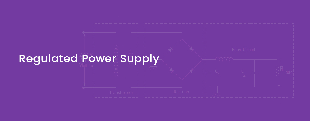

Yes, he explained it in the first paragraph. Power rail is commonly referred to as the "rail" where the amplifier gets its DC voltage from, and in essence that's the power supply for the amplifier. The power flow is, from the AC outlet to the power supply supply transformer, to the DC rectifier bridge and the output of the rectifier bridge is connected to the so called "power rail".
Below is a power supply block diagram, the simplest one I could find on the net, without having to worry about copy right:
In a real practical circuit, you can imagine the output of the bridge rectifier will be connected to what we call the "DC power rail", that powers the amplifier circuitry.
