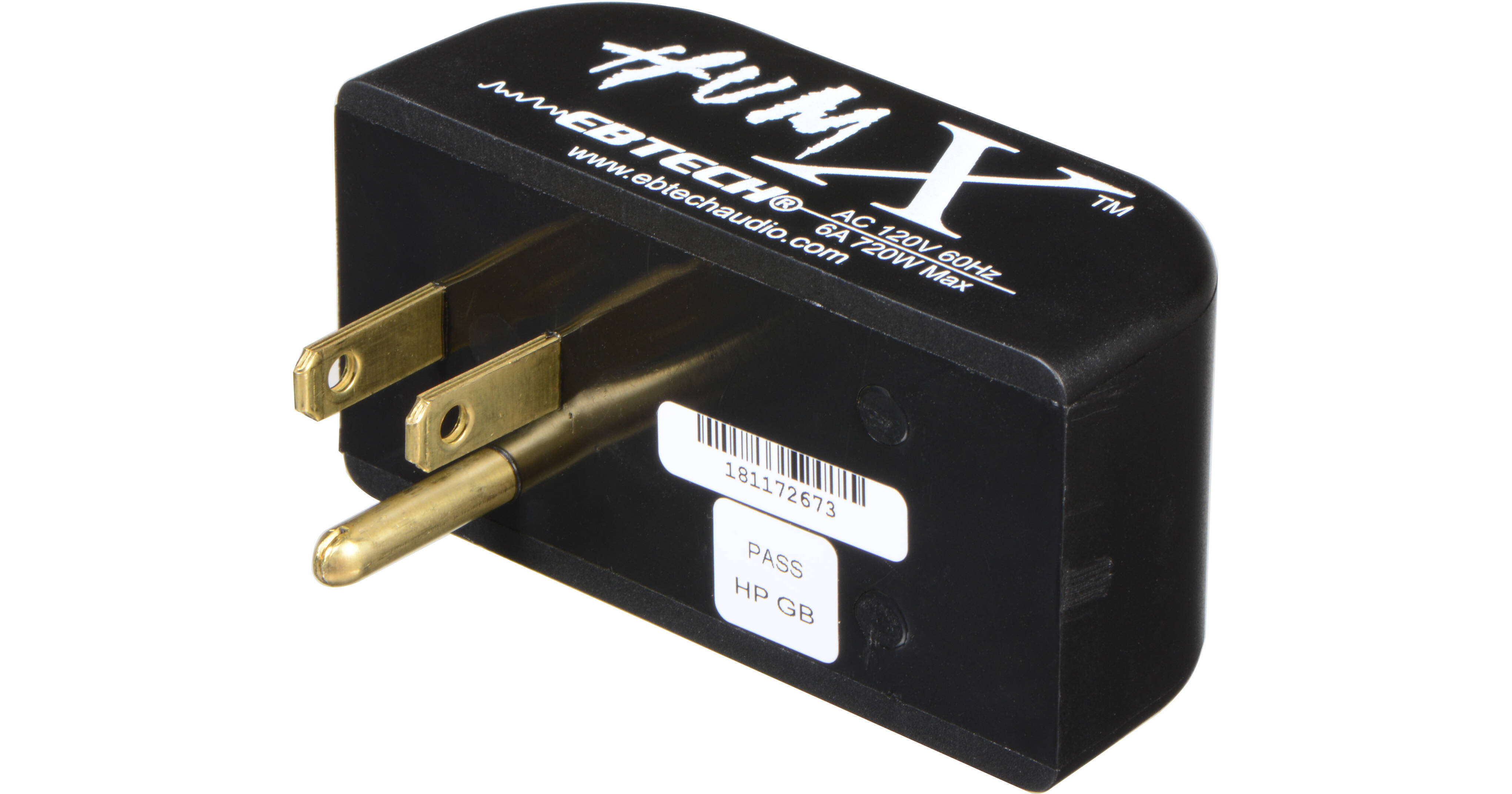

PENG
If you have a ground loop, I'd look into a Ebtech Hum X. They do work. You could test with a $2 cheater plug and if that take the buzz away then buy the Hum X
I doubt ground loop is the issue. Heater won't do that to one particular amp. It is likely harmonic, but then the heater must be one that has some kind of variable speed fan, or other sort of electronic controls. A simple baseboard heater is basically a resistor so it won't inject harmonics.
