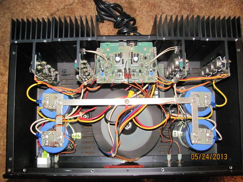

Look at all of that heatsink surface area and mass. Remember, heat rises. This is a well-thought out design. I wouldn't place this amp in a tightly packed cabinet, though if the cabinet has a fan or two it might work.
These are the types of heat dissipation designs that lend to amplifiers that deliver 25-30 years and more of trouble free operation. Heat is always the slow killer of any component, the cooler they run the longer they last.

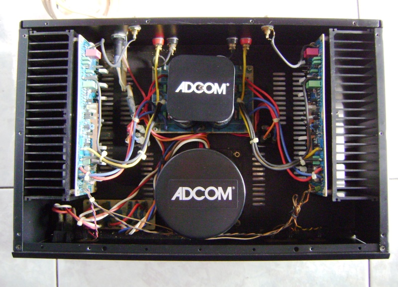

The amp in the lower picture is not an efficient design. Note how the output transistors are not mounted directly on the main finned bodies of the heatsinks.
The amp in question is the Nelson Pass designed Adcom GFA-555, cira 1984-1995
As of today there are 20 listed for sale on ebay, all stated as in good working condition.
None are currently listed as inoperative or for parts only.
After 21-32 years in service that's says something about their "inefficient cooling" design. ;)
Once again, if you pack as many components in a single 17" wide chassis as possible with little
room for circulation the heat and time will eventually take it's vengeance.
Even given the belief that all modern apps sound the same, if you purchase amps on the highest watts per dollar path, somethings gotta give. First on that list will be life expectancy.

I agree that the physical layout and design looks to be inefficient for heat dissipation.
But, that isn't the full story. I'm curious what the quiescent state is on those, quite possibly biased heavily towards class B so that an inefficient heat dissipation isn't a killer like it would be if biased to pure class A.

So you are comparing two channel amps to a 7 channel, wonder how their designs would look with a few more channels stuffed in there :rolleyes:
Well wasn't that my whole point? There are tons of variables involved, class of operation, power supply designs, etc. But trying to stuff so much in a single 17 format for cost savings just isn't the best idea if long term reliably is taken into account.
For my 7.1 system I'm running 4 separate stereo amps. Also offers the advantage that if one amp goes down I'm still up and running a 5.1 system while that single amp gets repaired/replaced.
BTW, I purchased my Adcom amps used off ebay for just about half the cost of the Monoprice under review.
