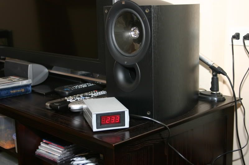

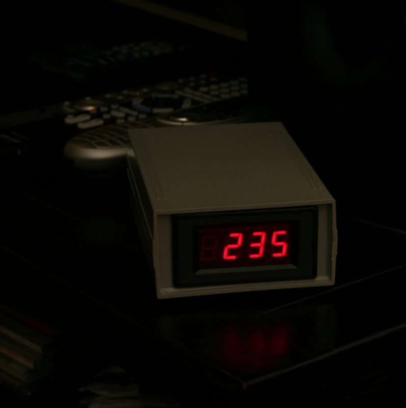

i also ordered a simple digital voltmeter to check on the voltage coming in from the power co. (using a multimeter, i think it jumps from the regular 220-230v to 250)

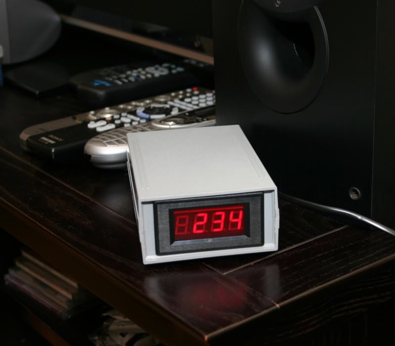

so i aside from the NMT and HD i ordered, i also ordered this digital voltmeter :) the wife should go out of town more often

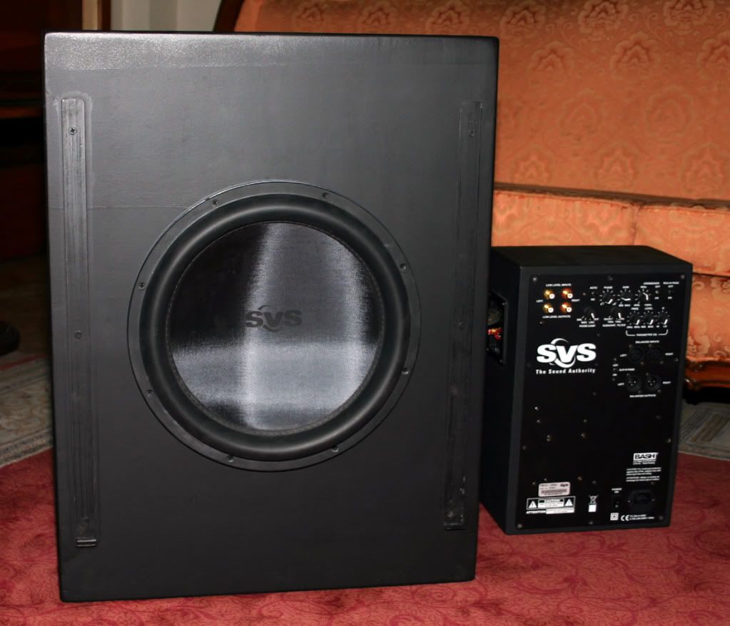

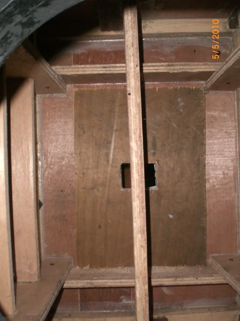

i'm gonna try to put the drivers from the flooded u l t r a s into this new sealed enclosure (same size as the original). i was too lazy to put the ports back in.
i plan to move my setup to a smaller room so hopefully, these two and my original three u l t r a s will be sufficient in sealed mode in a 2k+ cubic foot room.
if it's not, i'll use the two as left and right subwoofers (and as L and R wide speaker stands)

I'm glad you're trying to recoup what you can from those subs. The build looks very well done! I assume you received input from either SVS or some forum member about desired volume/dimensions with a sealed unit? Good luck!

i didn't ask SVS anymore, a new enclosure is a bit too steep for me (especially when i don't know if the drivers willl last due to being exposed to that much moisture)

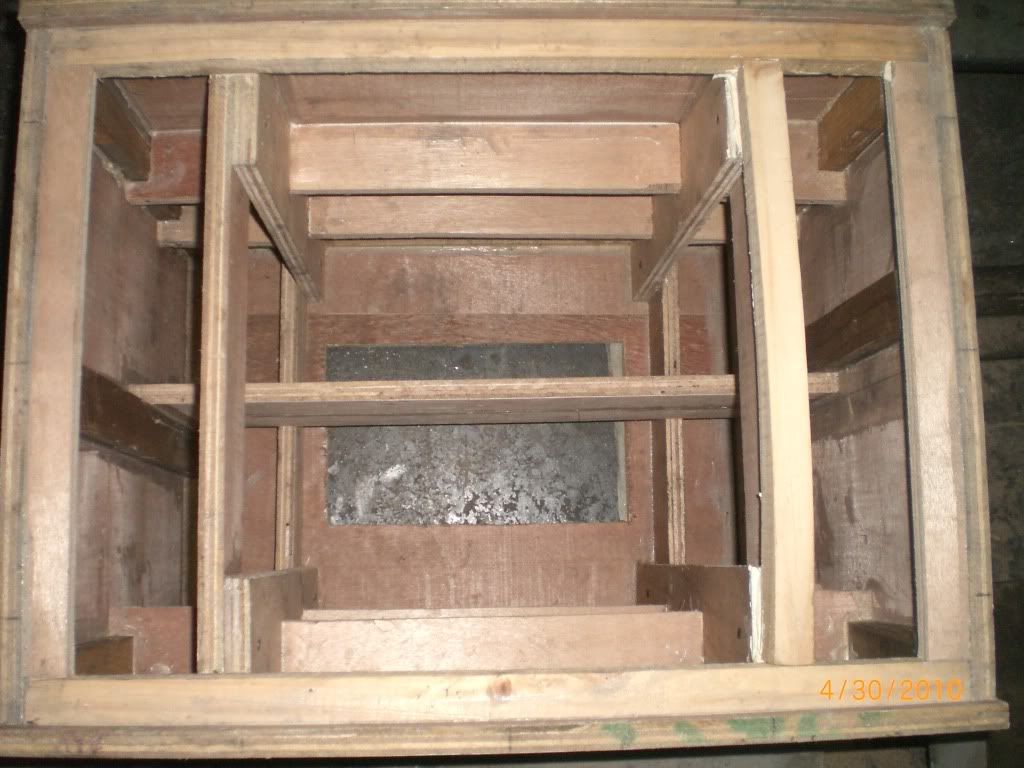

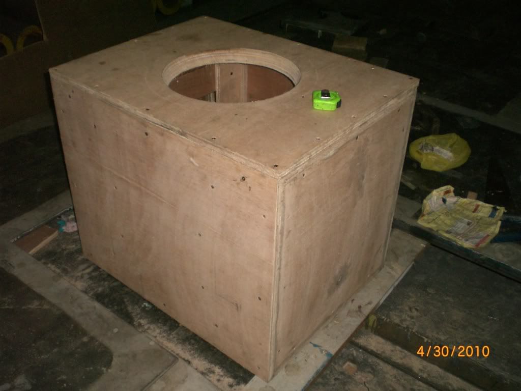

i built the enclosure to the exact same internal dimensions of the original enclosure with margin of error leaning towards bigger. i also wanted it to eat less footprint (thus it's tall instead of long)
if i had put some more effort to it, i could have made the vertical braces stronger, i was too lazy to measure the driver more accurately so i could make the braces "hug" the driver more closely.
still, not bad for two days work. i should be installing the driver and amp on tuesday (monday's a holiday)
the question is, should i build the second enclosure with the plate amp also built in or should i just install a speaker terminal on the second one.

I vote for speaker terminal. Because yeah I remember sometimes, well if anything goes wrong with a SVS, it's usually the amp, which then sometimes destroys the driver (IIRC).
If it's easy to keep all components as "separate", that's what I vote for.

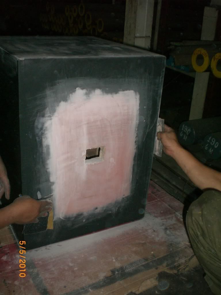

remember that plate amp cutout? my minion based the measurement on the old cutout (yes, the one that got fat from all that water) instead of the actual amp. he is now being tortured in my secret volcano island headquarters.
thought if i* was gonna redo the cutout, might as well make them both use terminal cups:
*"i" of course means my other minions
rmk
rmk
remember that plate amp cutout? my minion based the measurement on the old cutout (yes, the one that got fat from all that water) instead of the actual amp. he's now being tortured in my secret volcano island headquarters.
thought if i was gonna redo the cutout, might as well make them both use terminal cups:
You and your minions ... :p
We have a saying here in the US; "the fish stinks from the head down" (or something like that :D).
Interesting plywood, I don't think i have ever seen 1" 4 ply :confused:

that's actually 3/4" plywood. but actual thickness is about 15-16mm only.
i told the minion to get the plate amp measurement as soon as he was ready, next visit i made, he already made the cutout. :D
