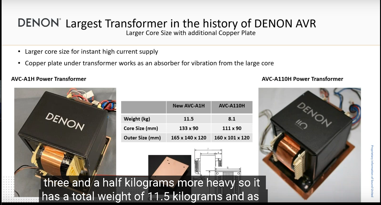

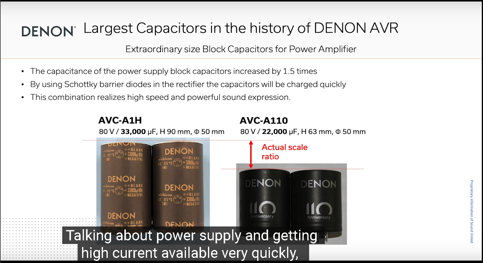

Denon seem to have discontinued the 3000 series and their top end AVR is now AVR A1H at 7199.00.
Power output is miserable though. No 4 ohm spec. No all channels driven spec. 260 watts 6 ohm only one channel driven and down to 190 watts 2 channels driven into 6 ohms. So even at that price it can't even be a decent 2 channel stereo receiver without the power supply being compromised. This is just not good enough.
A1H should be as good as it gets these days for av-receiver in terms of power output. Most people are perfectly fine even with much lower tier models when they pay attention to speakers (sensitivity / impedance / phase angles), but nothing seems to be good enough for you. I would make a big bet if someone were to swap your old amps & AV10 secretly and put A1H there without you knowing you would be singing the same praise still. Your hate toward av-receivers is very silly!
From Audioholics article: The fact that the A1H has an even larger power supply than the AVR-X8500H gives us high hopes for the amount of power this behemoth can deliver. In fact, we confirmed with Denon engineering that they bench tested the A1H is able to maintain 70% power for up to 9 channels driven! That would be 105w x 9ch driven continuously into 8-ohm load. Less useful information when real world program material being films you are not taxing all channels continuously in the way it`s been done in bench test. Not anywhere close. That`s why the ACD numbers are mostly irrelevant. Most people also have powered subwoofers taking big load off.
Audio Vision measured A1H.
- 2 channels driven 4-ohm 287w
- 2 channels driven 6-ohm 222w
- 5 channels driven 4-ohm 204w
- 5 channels driven 6-ohm 171w
- 7 channels driven 6-ohm 153w
ASR measured A1H 2 channel driven 4-ohm, 83dB SINAD = 0,01% THD+N @ 242w. For short peaks 350w 1% THD+N 4-ohm.
