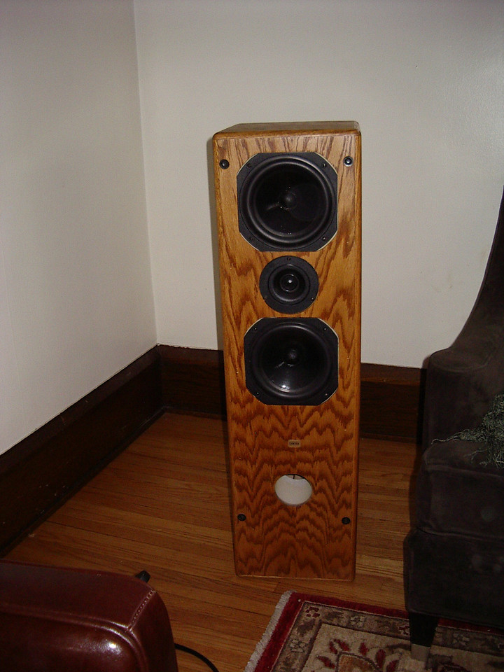

Here is a view of one of my cabinets built that way. This was an audiophile sound of first place winner
It actually turns out to be a slick way of building speaker cabinets.

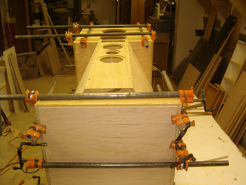

I don't have a really good picture in my library. However this picture show the principle.
If you look at this board showing there is a dato all the way round for the trim. There is a dato half the thickness of the board, all the way round the boards it fits in.
This way you can use pre veneered board which hold up better. Clamped with Tightbond the cabinets are very strong. Use tons of it, just don't get it on the veneer, or wipe it off right away with a wet rag if you do.

Now I get it. That's great. I just need to get more accurate at cutting.
